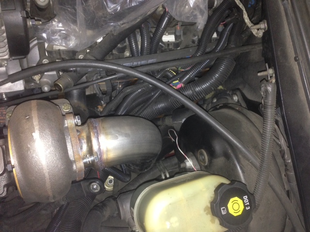

Originally Posted by TrickPerformanceProducts
sorry guys wrong pic.
this is what yall asked about. Hard to see but there is at least 1." around the steering link. The injector driver added the bulk of the wires in the pic. Customer will need to reroute the wires away from heat.
I would recommend wraping the dp with a single layer of wrap, and putting a heat shield around the brake res. and booster area. You do not want to boil brake fluid. Makes stopping a real pain.
Just wrapped up another single build so I will get back on the twin mounting the IC and wrapping this build up.
Still need to locate the gates, I wanted the IC mounted first so I can figure out were the gates can go.

How's this.
