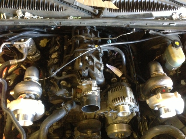

sorry guys wrong pic.
this is what yall asked about. Hard to see but there is at least 1." around the steering link. The injector driver added the bulk of the wires in the pic. Customer will need to reroute the wires away from heat.
I would recommend wraping the dp with a single layer of wrap, and putting a heat shield around the brake res. and booster area. You do not want to boil brake fluid. Makes stopping a real pain.
Just wrapped up another single build so I will get back on the twin mounting the IC and wrapping this build up.
Still need to locate the gates, I wanted the IC mounted first so I can figure out were the gates can go.

Originally Posted by TrickPerformanceProducts
Does this truck have the brake proportioning valve?
Old Feb 12, 2013 | 04:14 PM
  #166
TrickTurbo's Avatar
Truck Sponsor
Joined: Sep 2006
Posts: 4,466
Likes: 62
From: Wichita Falls Tx.
Brakes are stock, never touched. You do have to nodge the lines under the master cylinder over a little but nothing to big. I just pulled them up off the frame clip, and moved over. Nothing was in a bind or kinked.
