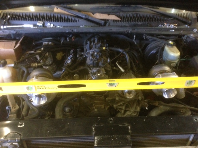

Posts: 9,447
Looks good!
Dumb question... does anyone offer turbos in opposite rotation so the twin guys can build the pipes symmetrically? It would help with appearance and easy of fabrication I'd think.

NRE has a patent on their "mirror image" turbos. Those are the only ones I've seen. Anyone else?
Their the only ones I've ever seen or heard of.

There is a bw unit. Out there that is reverse but its way to big for twins. Nelson racing would be the best option, but you're gonna pay for it lol

Not cost effective.

Update.
Right now no eta. Spent most if the day on the pass side manifold.
Wanted level with the drivers side.
Down pipe material has not arrived yet.
The gate config is a little complexing.
That drivers side is tight.
Wonder if the internal gated would have worked out better???
