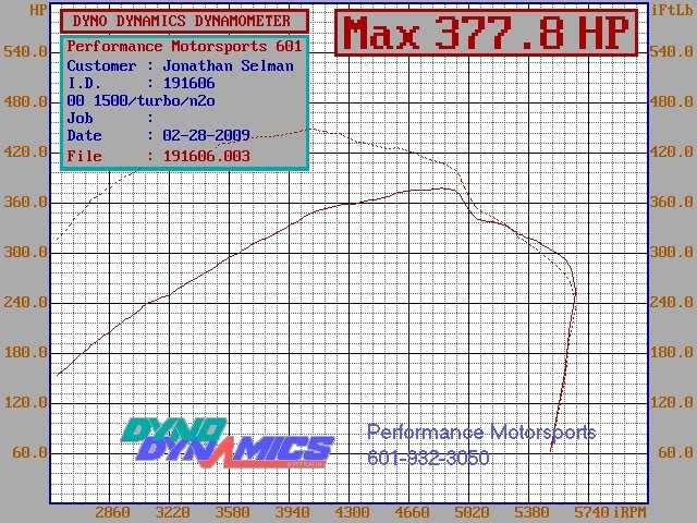

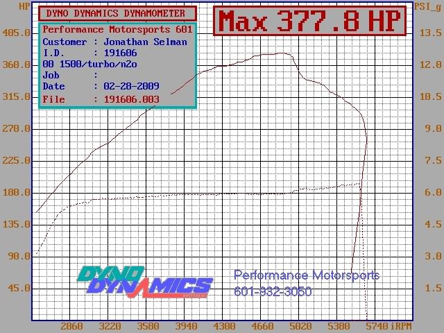

heres mine on 6# with the lil 60mm on a stock LQ4
Didnt load it up all the way on the dyno to get a lower RPM numbers.

This is my favorite one..
6# spring + 47 shot nitrous = ~7psi and alot of torque
