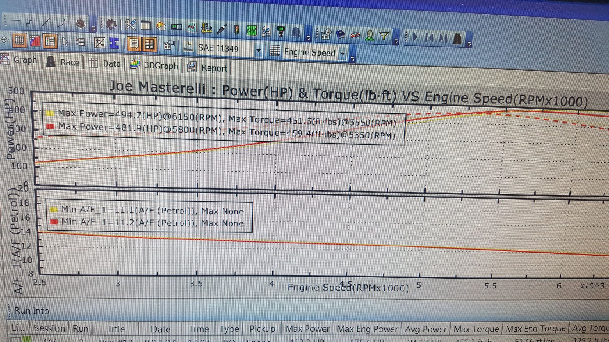

So did you get to the dyno
I did. Went to the dyno this morning, having issue with convertor unlocking and building boost. Got to 12lbs and made 523rwhp. Ran out of wastegate spring to turn the boost up more.
This was on California pump 91 @15deg timing. 0 kr
Another run only hitting 10lbs.
I have some video as well.

So do you still like the turbo over the pro charger.
Old Aug 25, 2016 | 07:48 AM
03sierraslt's Avatar
Posts: 19,007
Likes: 221
From: Western PA
Not sure if that graph is right for your AFR but if it is then add some fuel through midrange and your tq will go up noticeably.

I ended up adding some fuel. hopefully Friday we will see what she does at 16lbs, then add some E85 and let her eat.
Old Oct 12, 2016 | 03:33 PM
fctry286's Avatar
Joined: Feb 2014
Posts: 289
From: San Diego
Update.
Turned the boost up to 16lbs and ran a 4th gear pull. truck made 544rwhp and 545trq. ran out of fuel pump at around 5,000 rpm's. this was on cali pump 91 as well. Need to get an electronic boost controller and ill set boost to 14lbs across the board.
