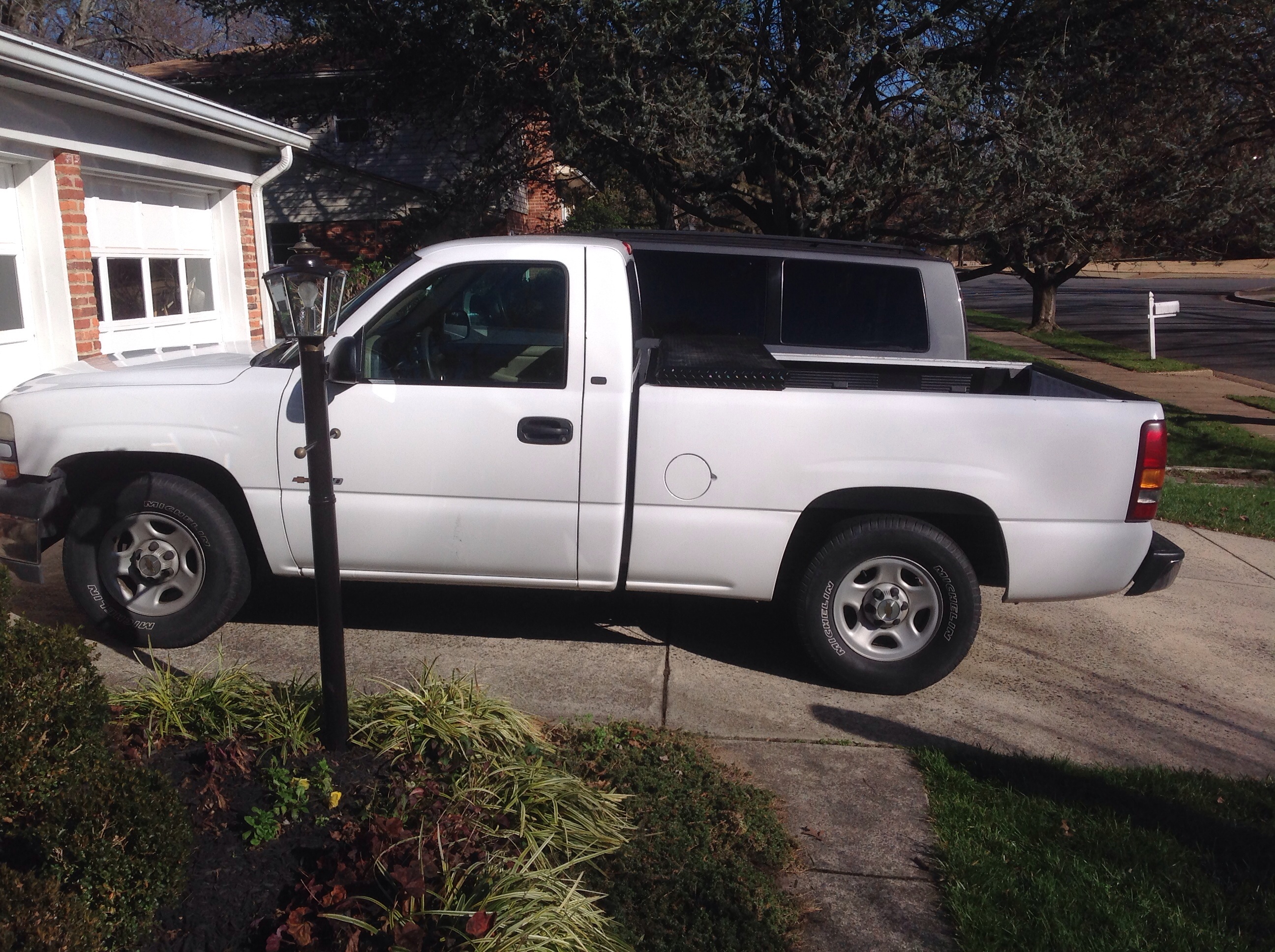

Here's some photos
Attached Thumbnails All Go No Show: budget bed-mount turbo build thread-image.jpg

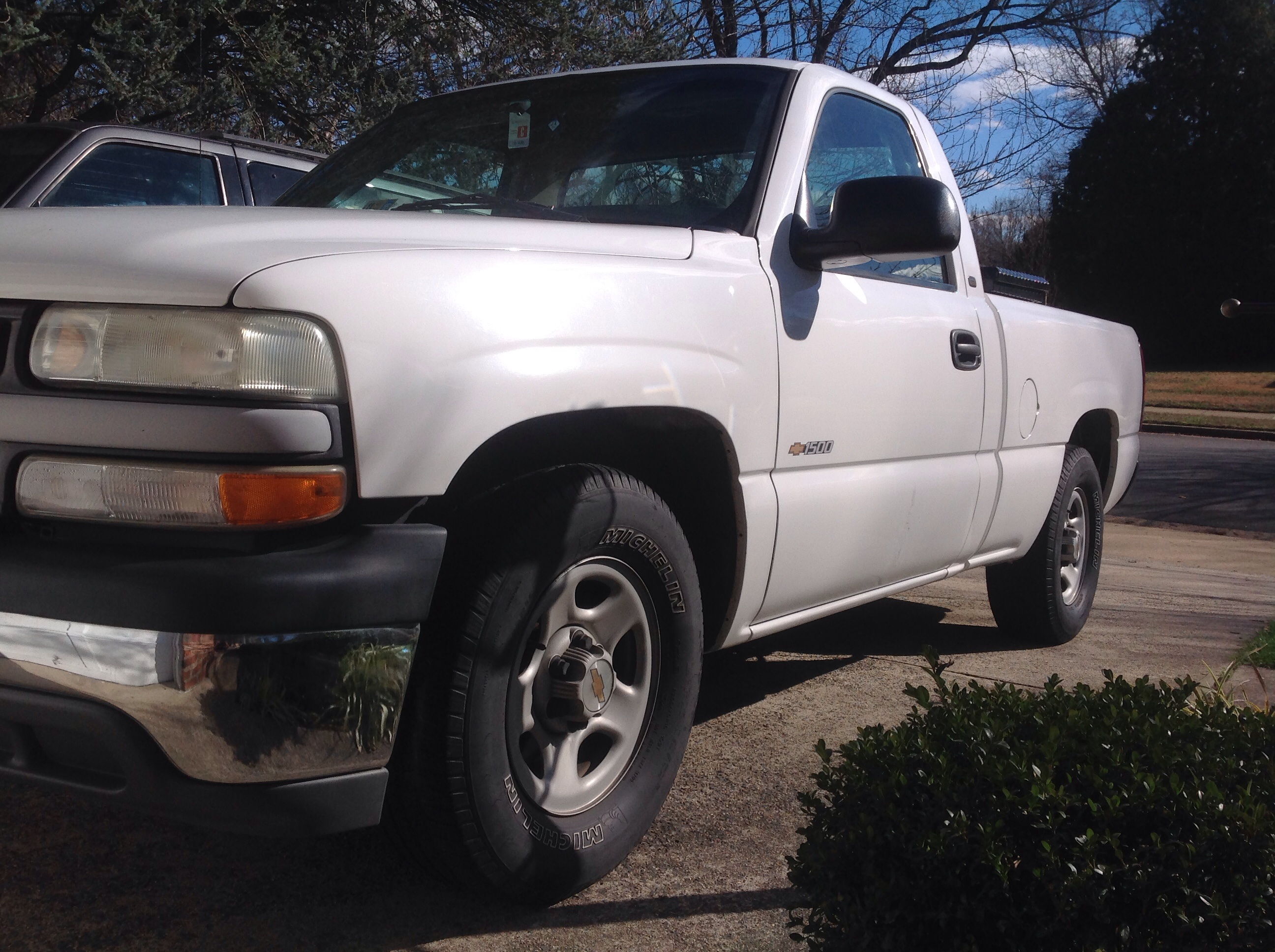

Another one
