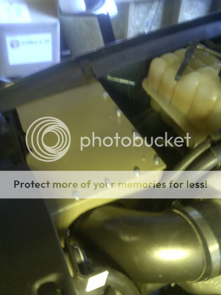

I made a quickie 3 sided airbox that extended to the grill on the engine side. The top and back boxed it in. I then used 1/8" ABS as isolator plates on the inside. It dropped my engine temps in the midwest heat by 15+ degreees in the summer. The track temps were evn better. Best part it took me 30 minutes and a 6 pack and I can swap between K&N and Spectre filters. If you have a quick template, hell churn them out as an option.

Im guessing the bottom is just completely open?
To me? There are 2 folds in the side and rear panels helping to divert air and seperate airflow. The bottom is wide open from the ground to the grill in my air box

I would highly recommend a bottom on the box I had my last air box on my 5.3 open and thats why it was the last box on that motor. Hit a water puddle sucked up water and bend a rod. So like I said i highly recommend a bottom on them.
