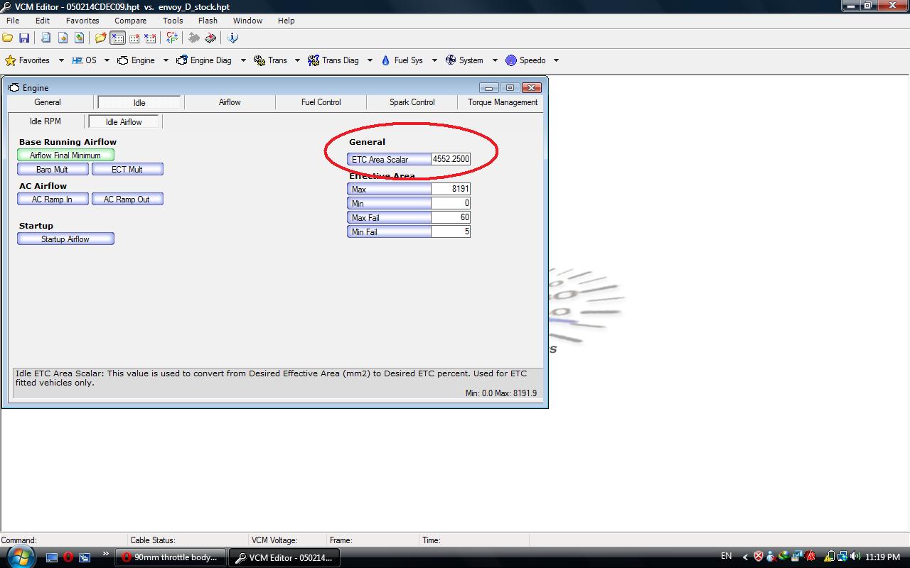

did you mean this , i had to write the recent numer here ???

That is the right place, but that is not the right number to use for a NNBS. It is correct for my truck. I believe you that number needs to be about 4725, but Dr.X can probably tell you for sure. I don't believe changing that number is going to make much if any of a noticeable difference for you application though.

I would try the 4725 if your calibration uses area rather than a factor. This may not make much difference, but it will be more accurate. This is the number used on the LS2/LS7 cars. Odd that the 8191 number is already the same as in the calibrations for those cars.
