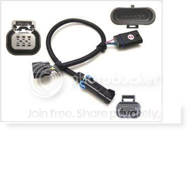

Can I get a better look at that Speartech wiring adapter?
I want to see the end that plugs into your truck harness and, your actual truck harness. My TB only has 2 pins and I hear some have 6/8 pins.
If its 0* outside, don't worry about it.
Sounds like you need something like this(not sure if it has the correct connectors). Just Google "LS2 throttle adapter harness". I'm guessing you have a total of 6 wires though if the 02 TB operates the same as the LS2 TB.

edit:
Looks like a total of 8 wires. It's just that the sensor signals move in opposite directions on the 02 trucks. Which is the similarity to the LS2 TB. So the harness shown makes sense.

The clip in the top left looks correct to plug intot he 90MM and the clip on the bottom right looks like the clip for my current TB. I don't know what thay other clip (top right) is for. Maybe the TAC which I don't need?
The 6 pin connector is supposed to mate with this one that plugs into your throttle position sensor:
