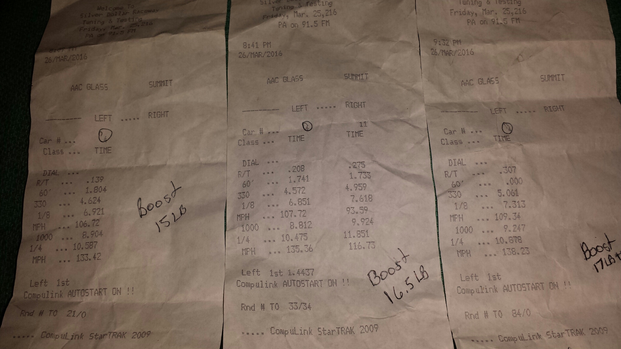

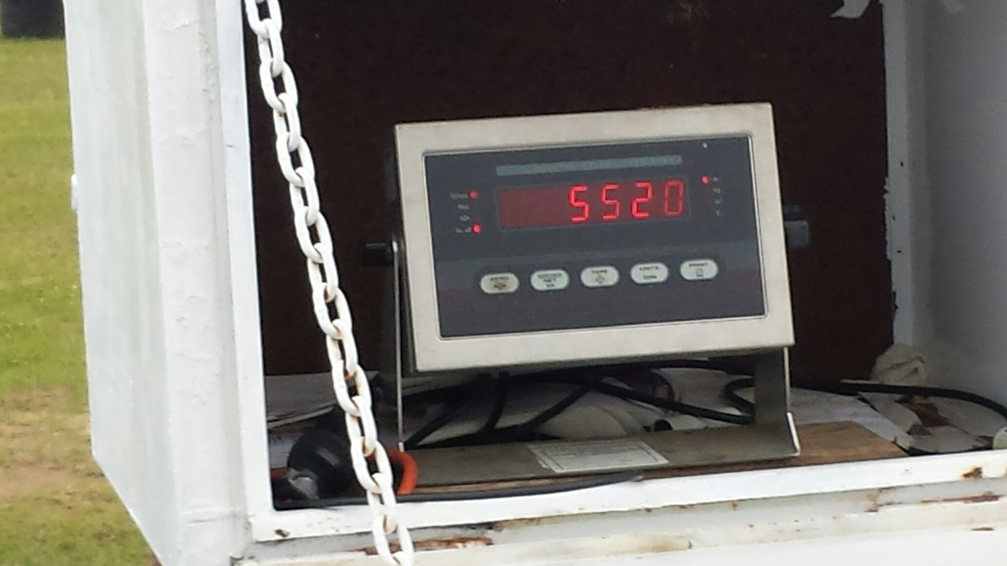

Guys the Beast just get better and better. First thing the new Trick turbo race intercooler is badass. I'm making more power per lb of boost. The Beast on the same dot tires got faster tonight first pass 10:58 133mph on 15lb total boost ramp it in. Second pass I added a little more boost 16.5lb and launched on 5lb. When 10:47 135mph and tires started shaking a little so I lifted a little and back to the floor. I think it was a low 40 run. Third pass the dew down on the track and some *** drop dirt on the starting line but I cross my finger and added a little boost on top and slow ramp speed but the truck blew the tire off the launch but I lifted off total and back to the floor run was awesome the whole way 1/8 mph was 109.34 wow and 1/4 mph 138.23 dammit the Beast was flying. Guys I think with a good track I can run 10:30s maybe 10:20s on the street tires. Slicks I hope 9:90 it's fun driving into the track and drop pressure in tires and remove abs fuses and run this fast. Weight again too and got a pic 5520lb with me in the Beast.

Turn boost up to 20 already.
138 trap is badass. Good for 9s

Yes, 20lb is in the works. Just need some good track time.

Hope to have a few more weekends of cool and dry weather before it gets hot. I really wanted to try out the slicks, race gas and more boost. One thing is the new shocks are working out good. With the double adjustments I've got the MT radial working good. 1.67 slicks vs 1.74 radial. But I'm having fun and that okay be me.

You need to fix your suspension or leave with more boost if you can only get 1.74 on mt dr

What are 2wd 18in radial truck doing in the 60ft?? I think on a good track I can do better. My slicks are 17in x 9.5 Hoosiers. I know I need a better 60ft but if these tires not sure I can get much better. What you think?

That's a lot of weight to start moving.
