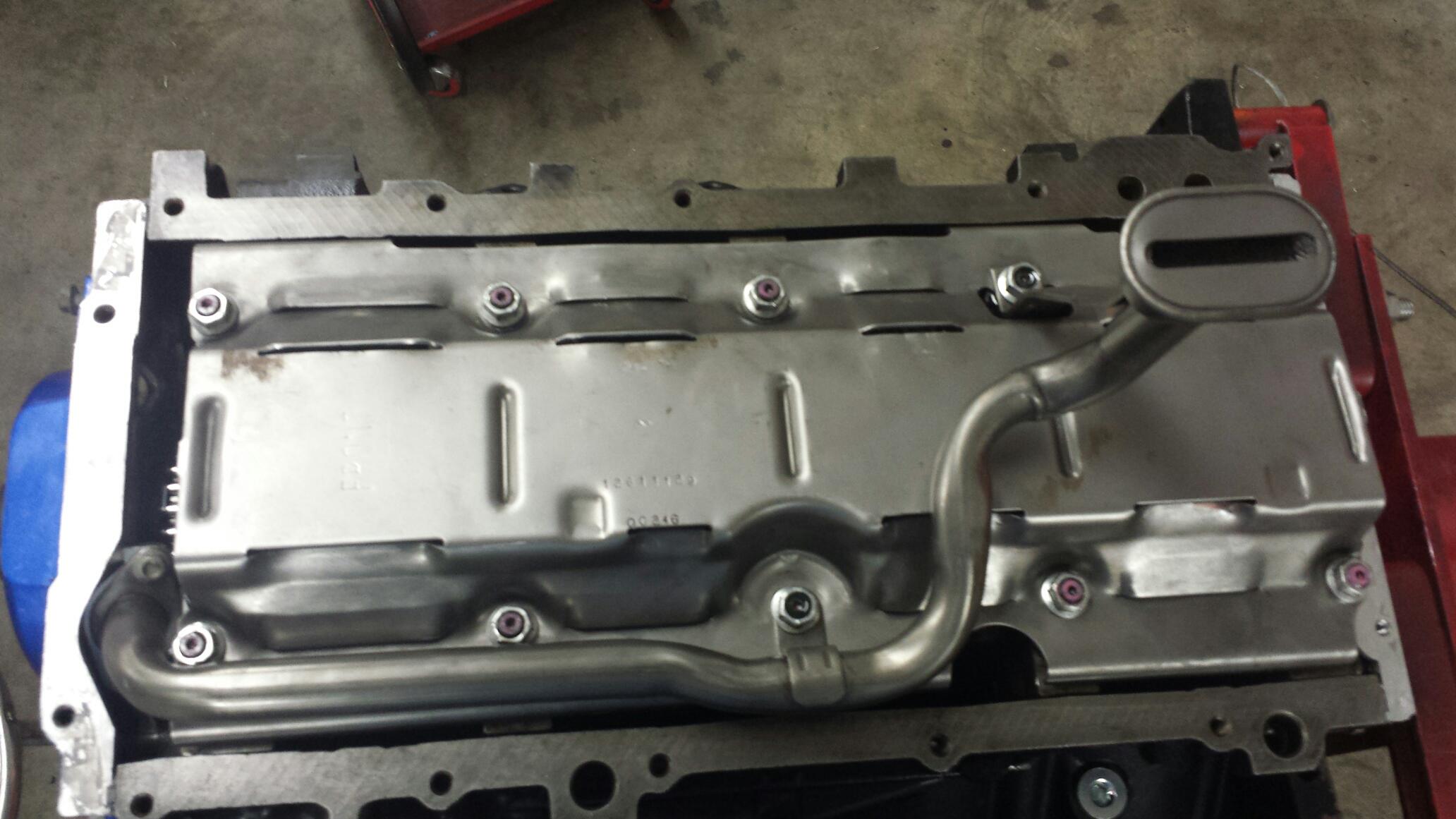

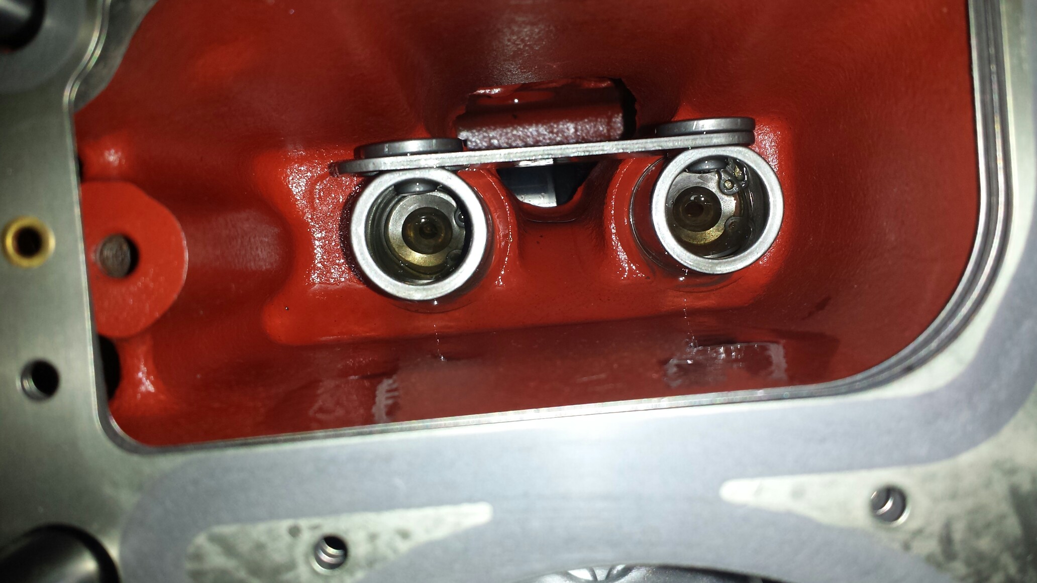

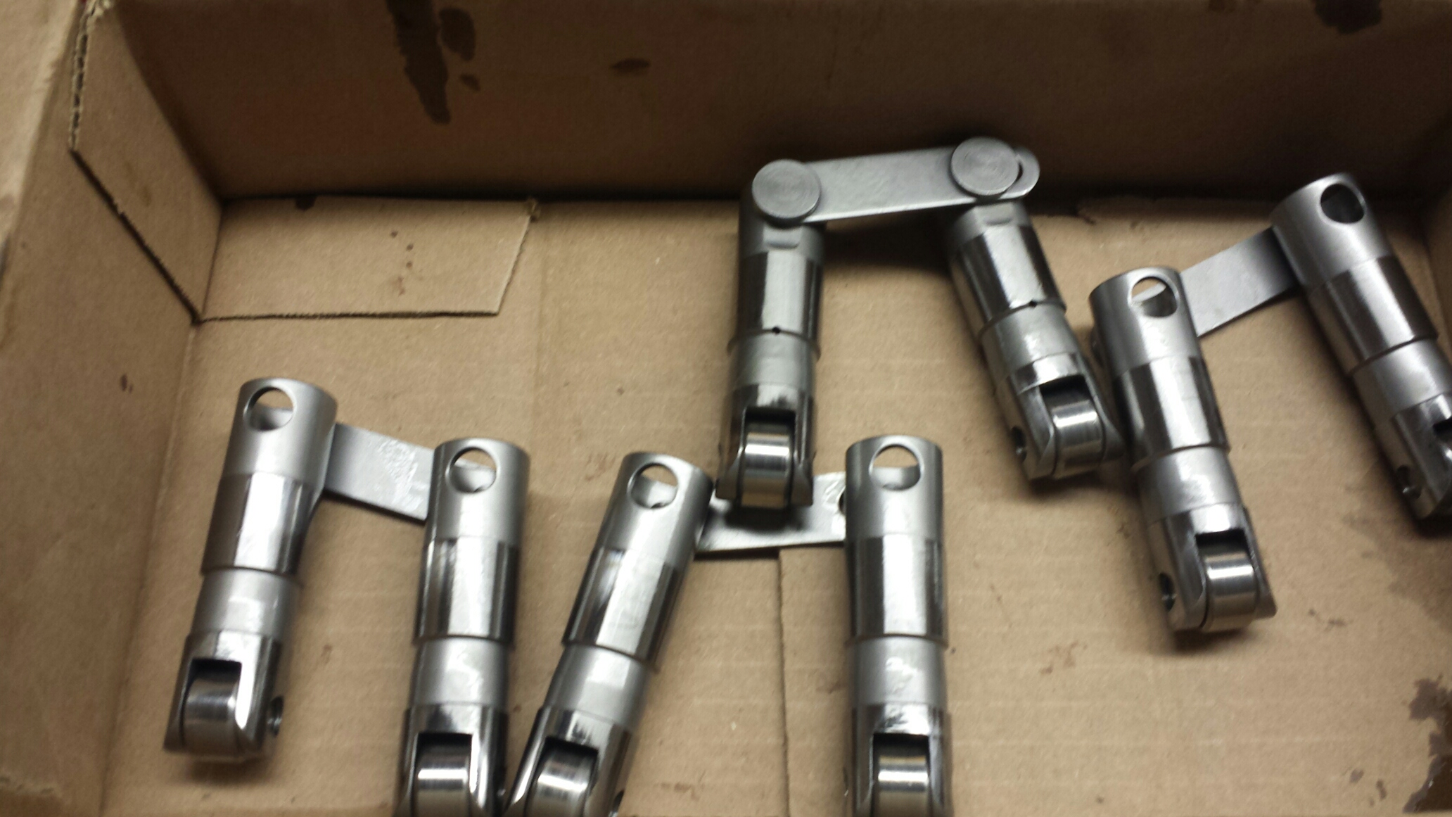

Update!!! install cam and setup cam 102 centerline. Install modded oil pump. I shimmed the spring .110. Install pickup and oil pump. I will install lifter next and start setting up the heads. 6.2 turbo build-9.jpeg

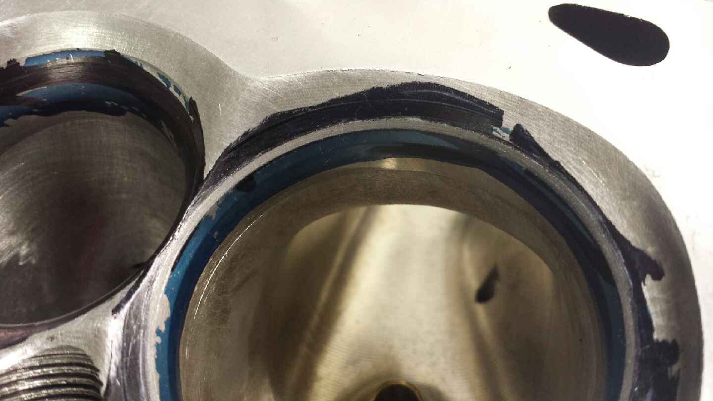

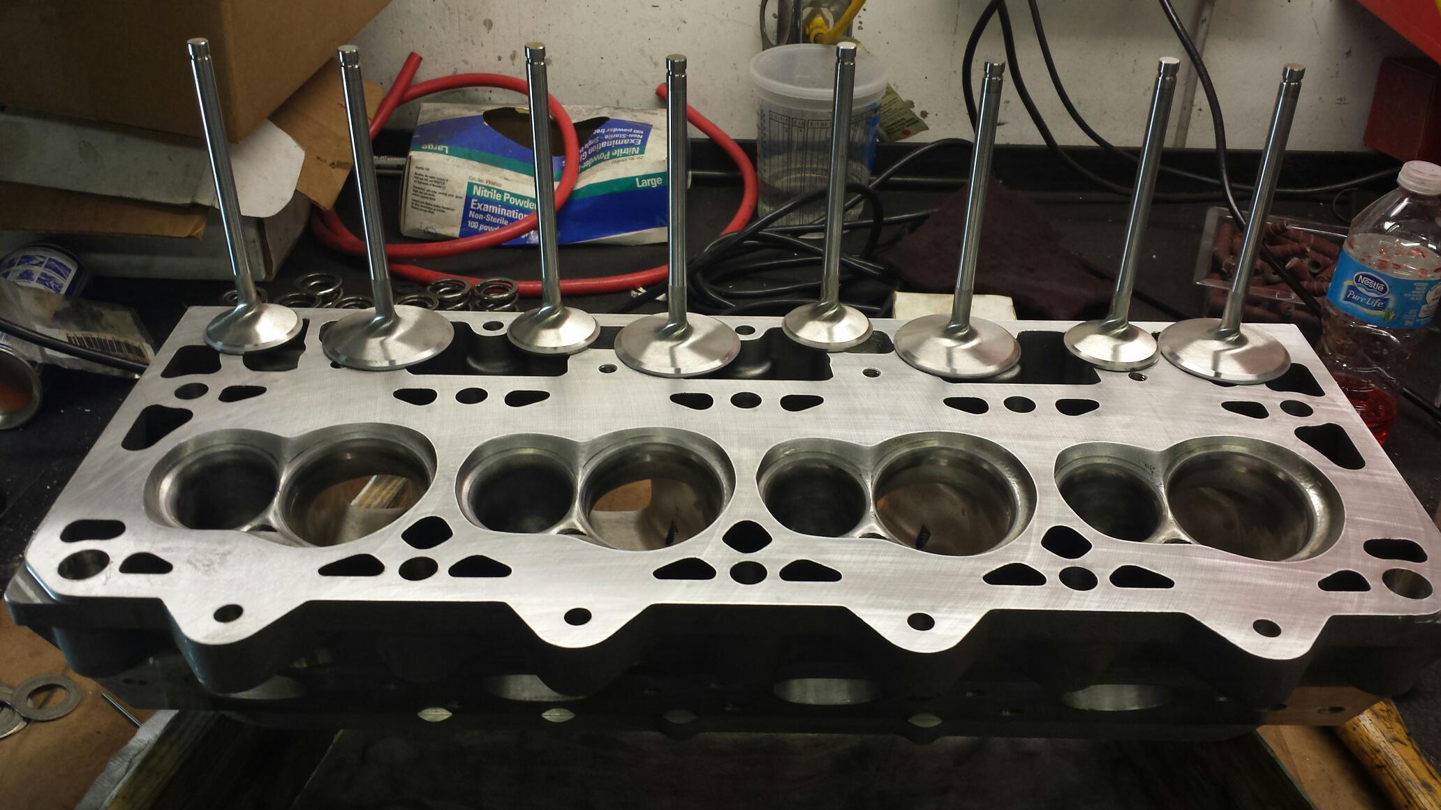

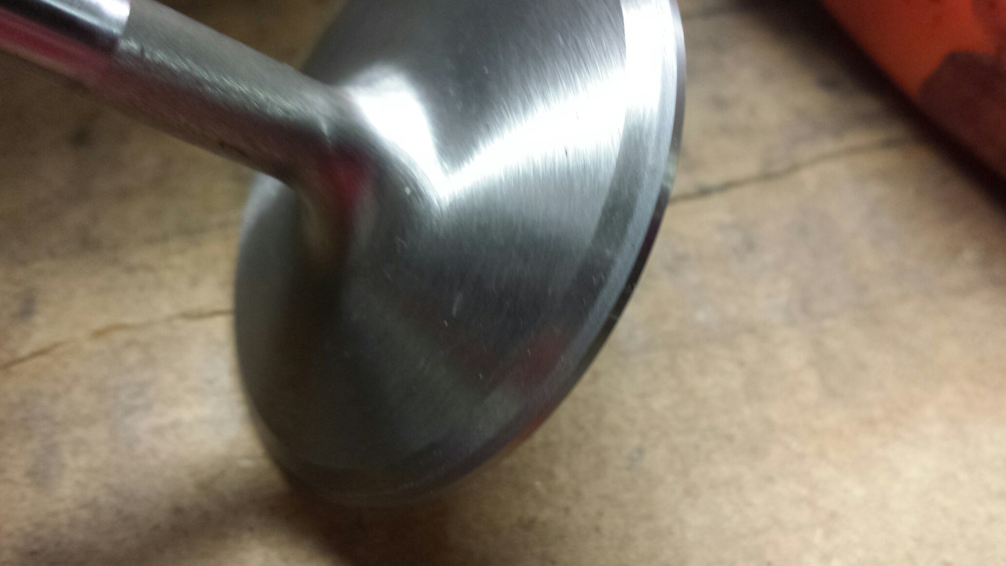

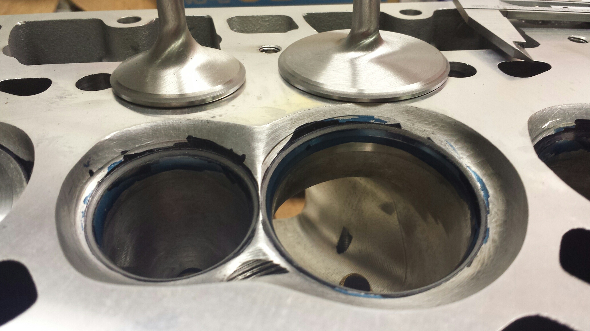

Today I started on the heads seat are done valves lap in and check in width of the seating. But run into a problem started to setup springs and found Texas speed sent me valve .100 to short. So I will send them back and get new ones coming monday. I would think the people who build the heads would send the right ones.... Well I did take a few pics. 6.2 turbo build-13.jpeg

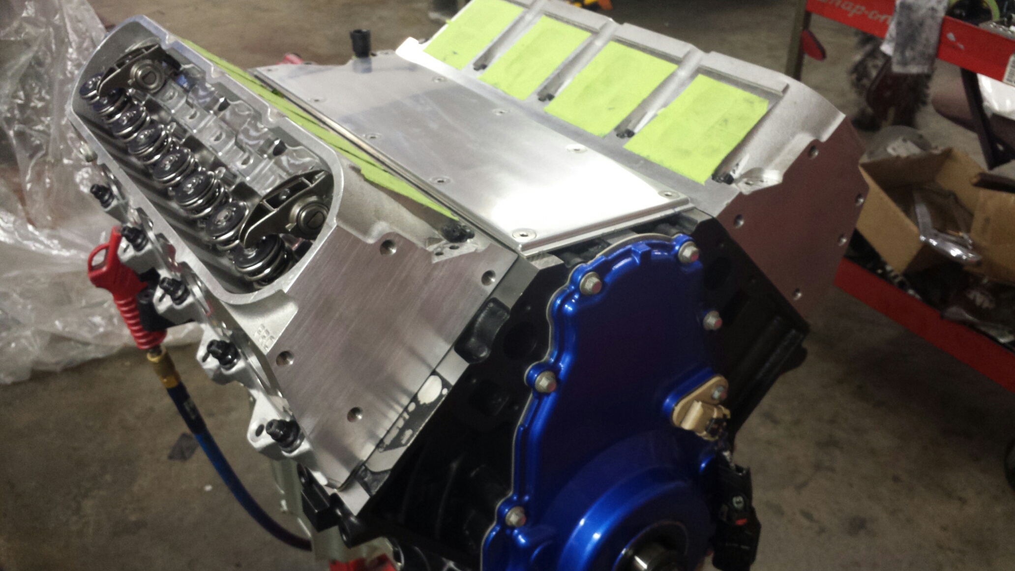

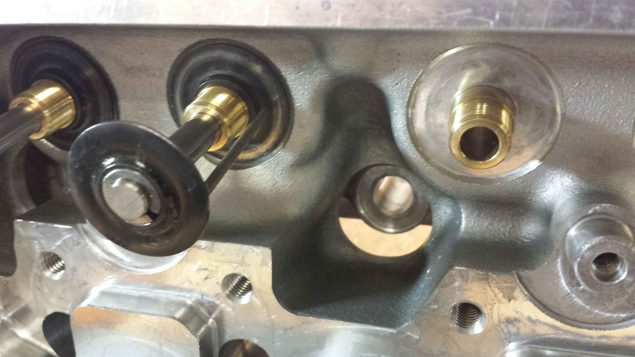

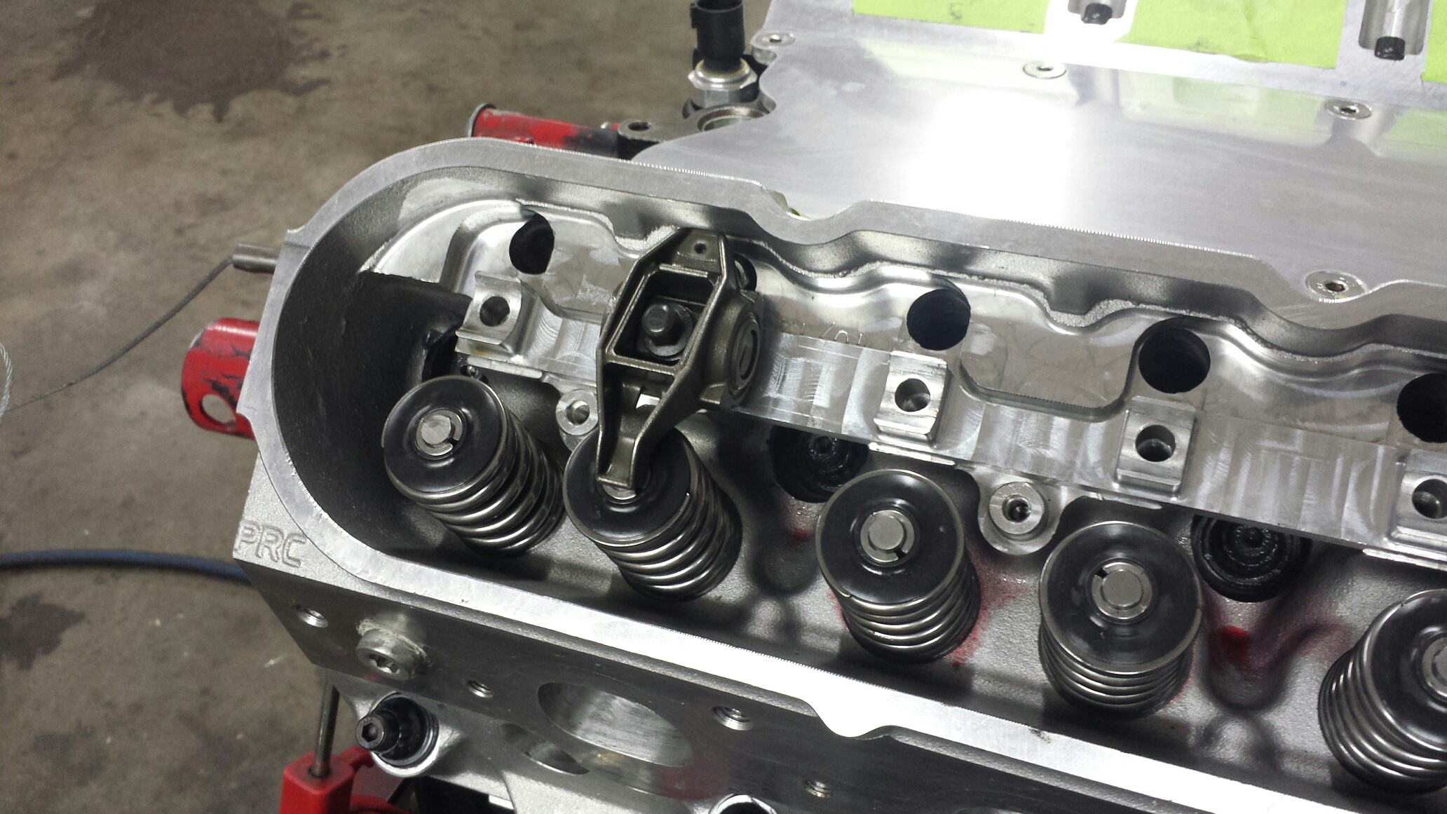

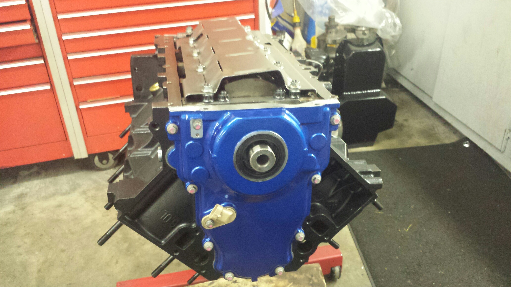

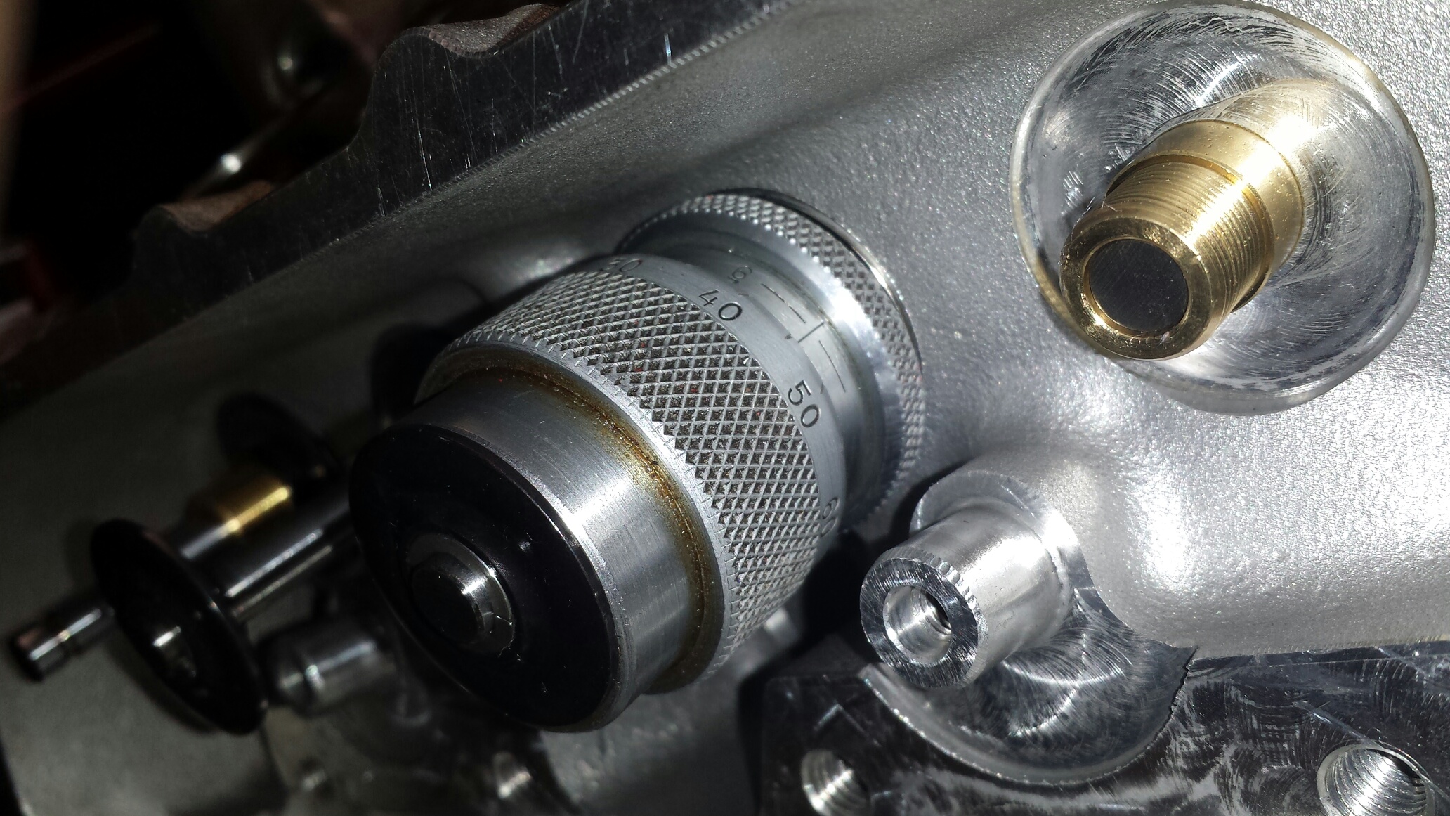

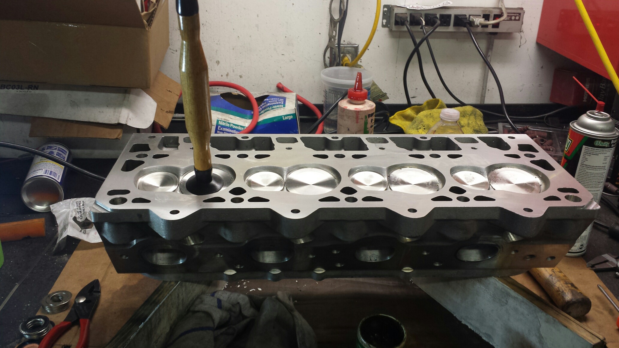

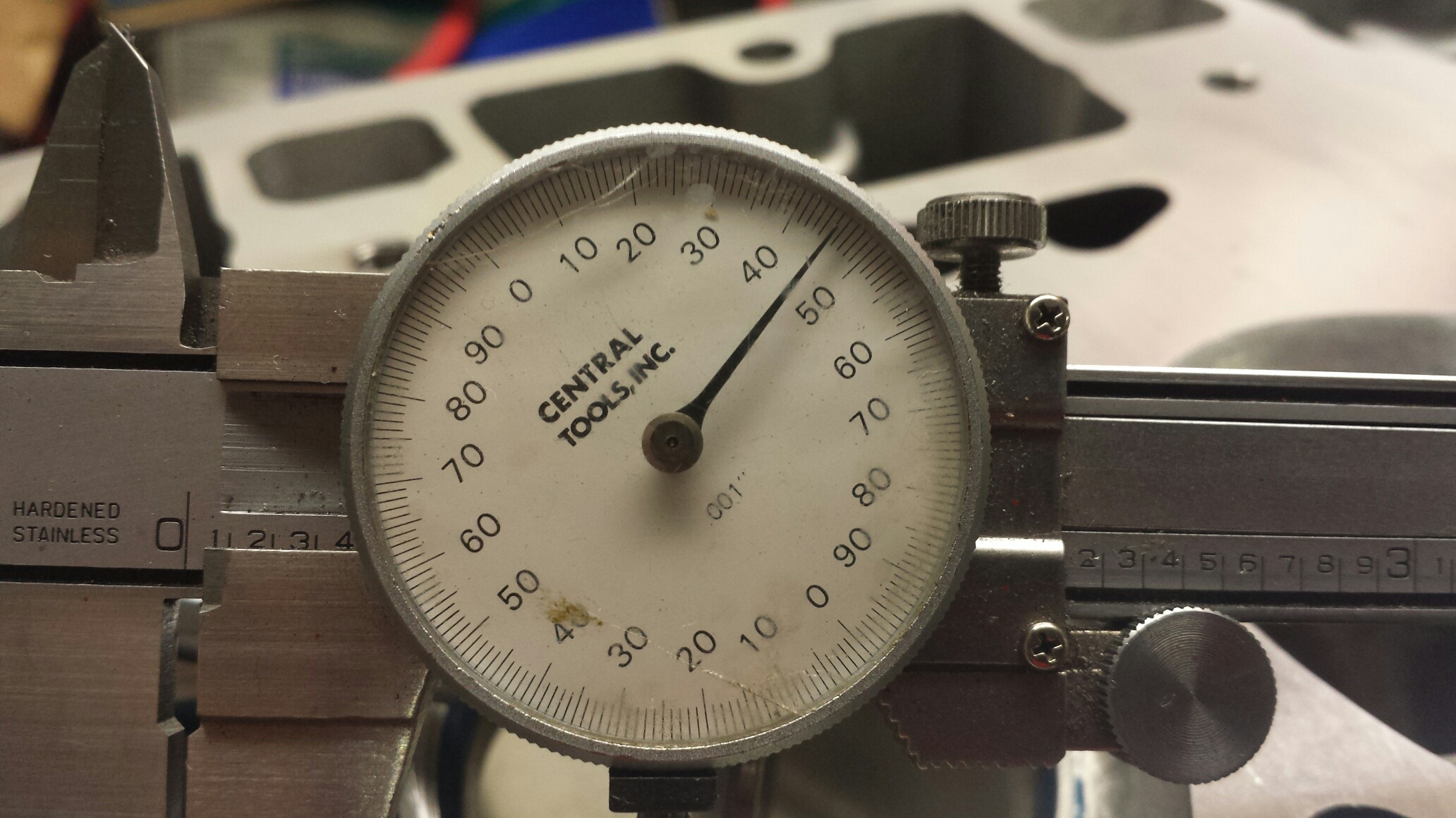

Update for today is heads are done and the engine is 95% done check pushrod length and I need pushrods. 7.475 Im showing two ways I like for check spring setup. One with pin and one with gauge 6.2 turbo build-.jpeg

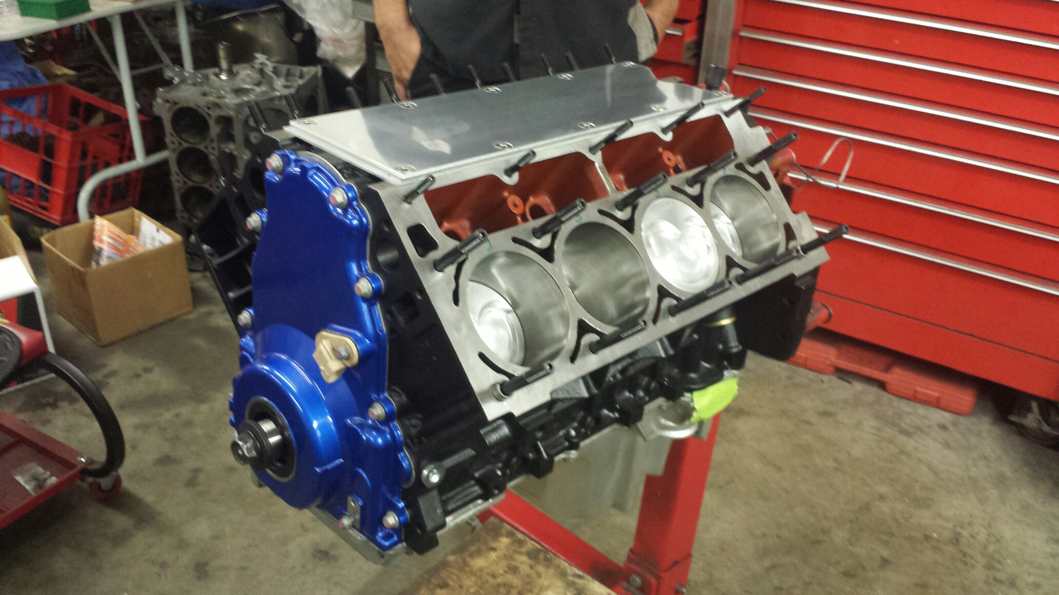

What do you guys think about me new engine?
Old Oct 4, 2014 | 10:35 PM
  #487
FFDP's Avatar
Joined: May 2014
Posts: 5,282
Likes: 600
From: Rogers, MN
I think I need to hear it run.
