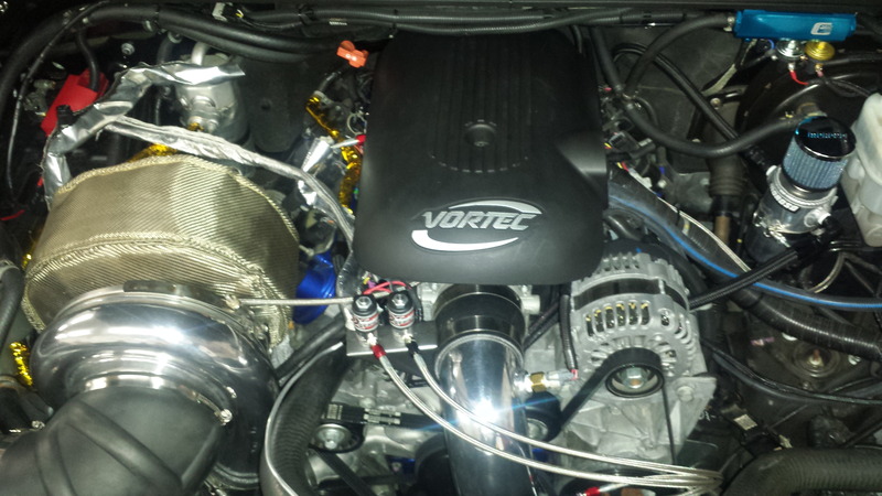

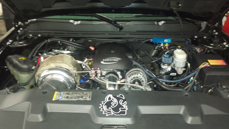

Size:  157.5 KBName:  20151013_204329.jpg
Size:  137.7 KBName:  20151013_204357.jpg
Size:  160.6 KB A few pics of the setup. The transmission is work great and transbrake is Awesome. New converter is still being tested. The new intercooler is flowing crazy so the boost on the spring is 10 to 11lb of boost so I'm changing the spring out for something lighter. Want to launch on 3lb of boost on street tires. The Beast does a lot of street racing. More info to come soon.
