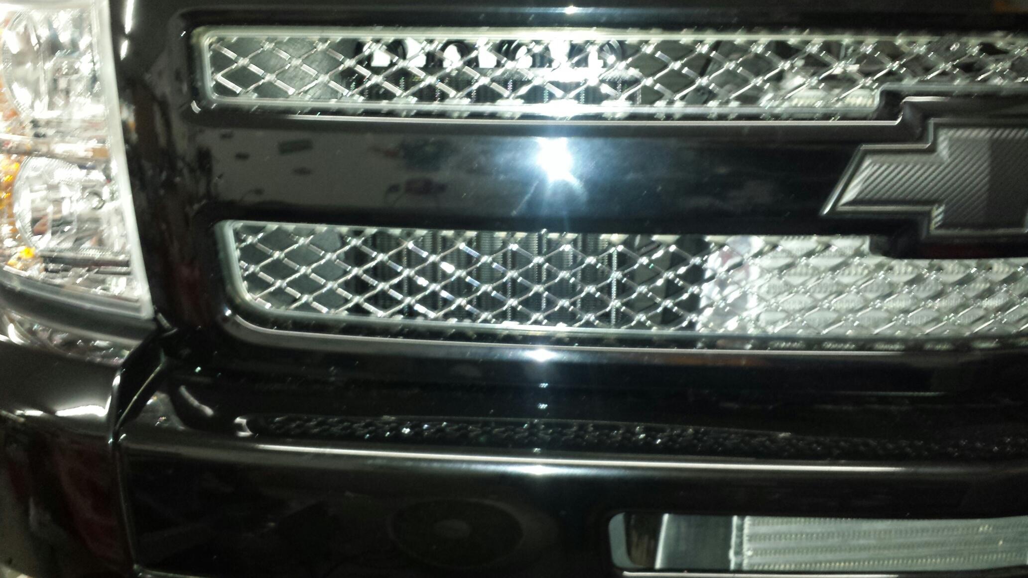

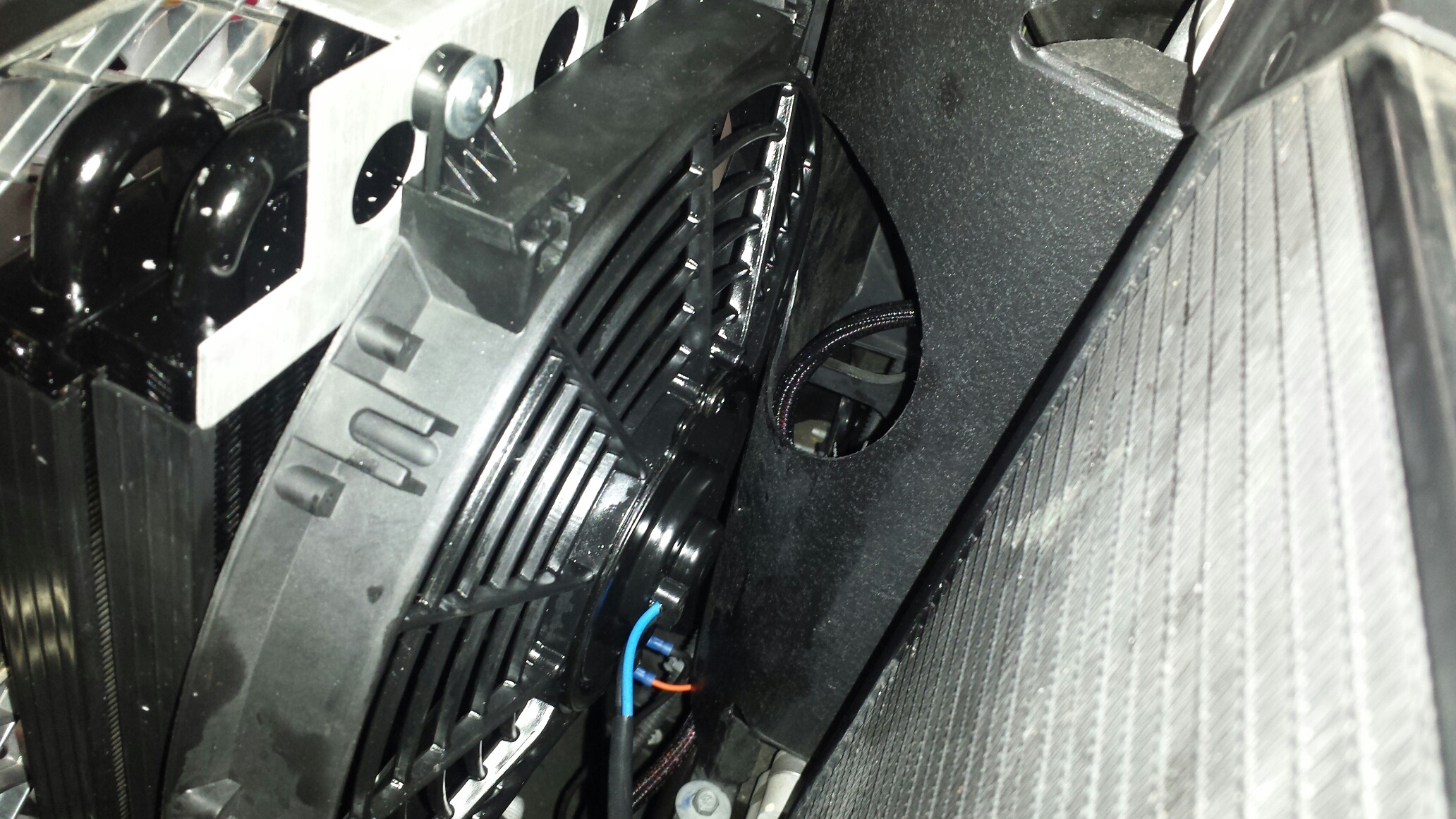

After and test drive I notice the trans temp running to high. After check the fan, it was working but the locate was not allowing air in or out. So I moved it to the front. Mounted it to the top of the grill and the bottom to the bumper. 6.2 turbo build-image.jpg
