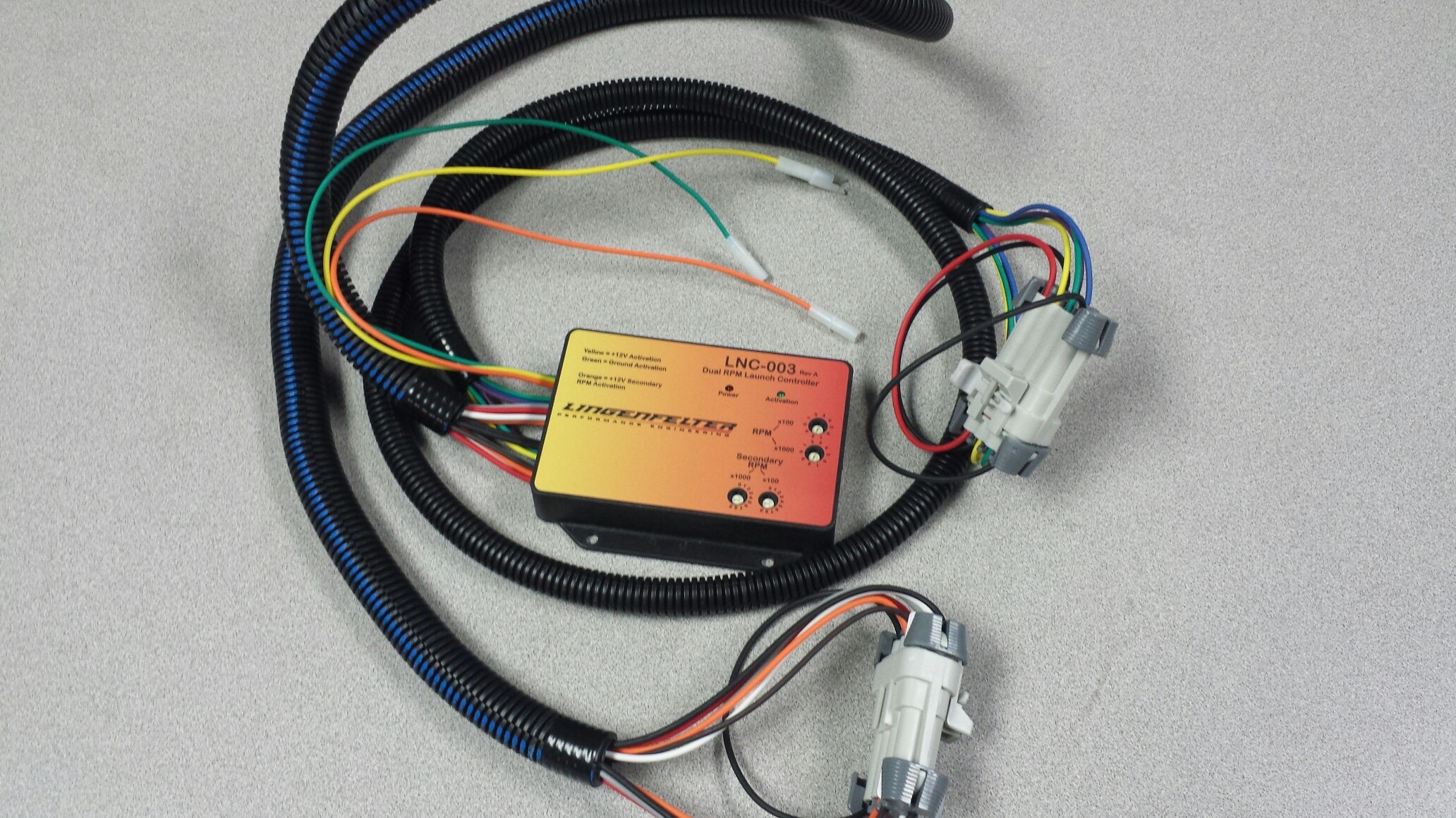

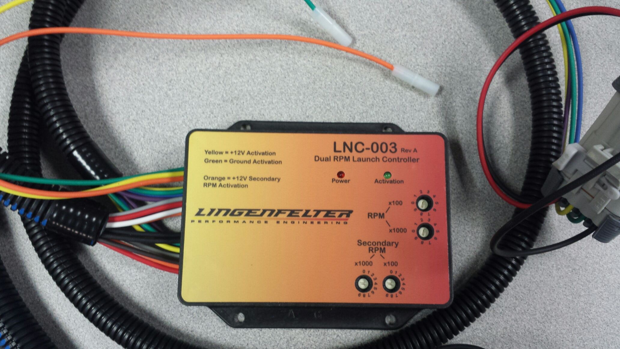

Tonight i installed the 2step and was foot braking 4lb of boost at 3500rpm. This is the way I did it started braking hard then I put in neutral rev the engine hard and the vacuum built by the throttle blade closing make the brakes go down and makes brake better. Then put truck in gear and push the hell out of the brake pedal. Start pushing the throttle down and the boost starts building. Going to start at this and work my way up. Don't know what the tires will hold.6.2 turbo build-image.jpg

Old Feb 11, 2015 | 09:31 PM
  #783
TrickTurbo's Avatar
Truck Sponsor
Joined: Sep 2006
Posts: 4,466
Likes: 62
From: Wichita Falls Tx.
Originally Posted by Byrdman11
What's the 2 step set at. Rpm?
Old Feb 11, 2015 | 09:37 PM
  #784
Byrdman11's Avatar
Joined: Mar 2012
Posts: 1,791
From: Macon Ga
Started at 3000rpm work my way up the 3500rpm. I'm not sure if the converter, brakes or the tires can handle much more. Going to the track again soon.

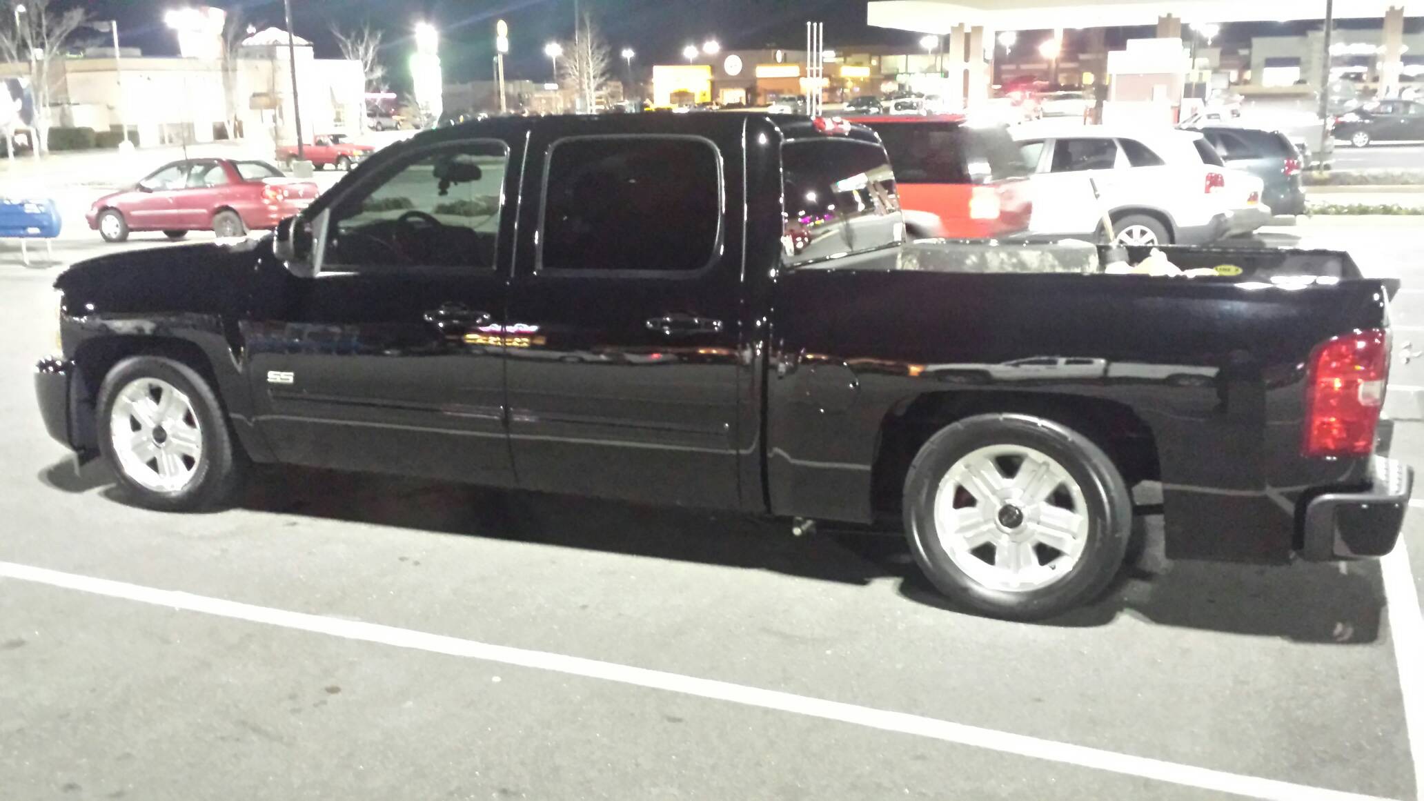

6.2 turbo build-image.jpg After the track I had to stop and picking grocery. But the Beast don't mine.

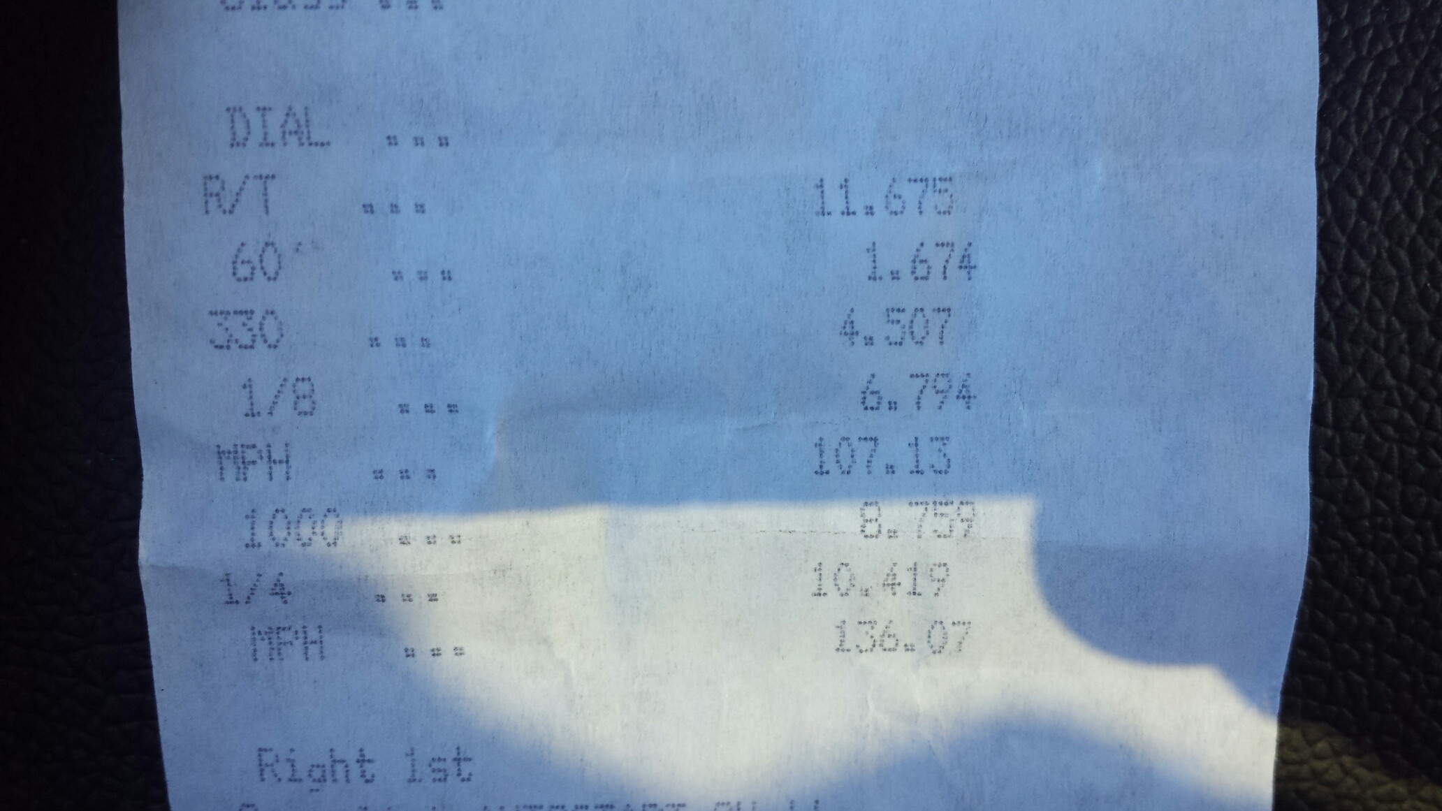

Guys the track day was awesome. Foot braked 5lb and was ramping in the boost a little fast and was hard the tires a little to hard but with time and more boost on the launch and ramp in a little slower I can improve on my best run for the day. And that run est 1112.83rwhp 6.2 turbo build-image.jpg

Old Feb 14, 2015 | 07:12 PM
  #789
GMCtrk's Avatar
iTrader: (27)
Posts: 12,275
Likes: 19
From: Dallas
Very nice! Put some 15s on it.
Old Feb 14, 2015 | 07:14 PM
  #790
Byrdman11's Avatar
Joined: Mar 2012
Posts: 1,791
From: Macon Ga
You are so right!! The slicks are yelling for help bad. And I have them on 19lb cold.
