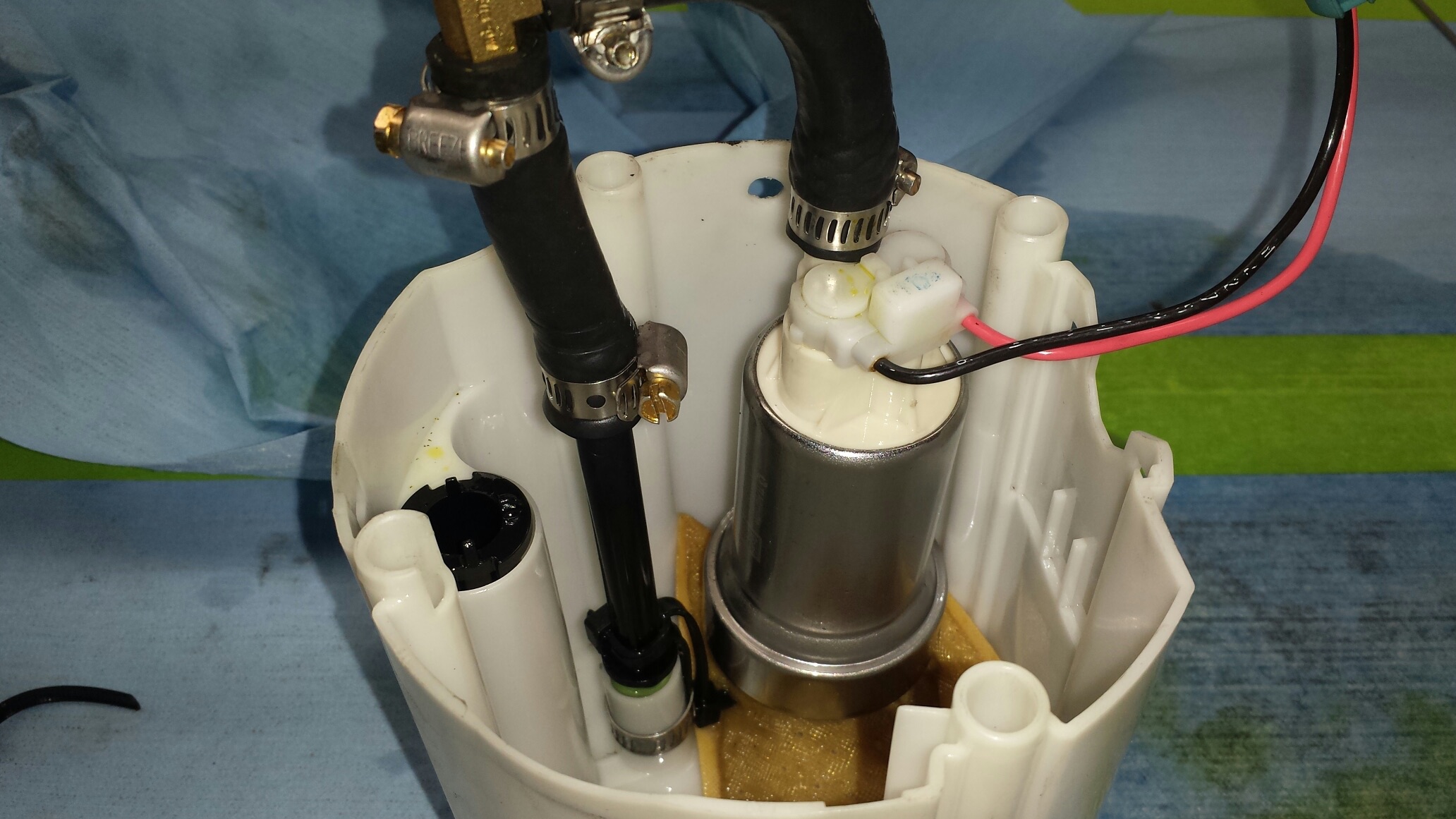

Well I almost got the fuel system done. The fuel system is twin 450's one is setup like it was powered by the stock FPCM and the other is setup powered by a hobby switch turn on the pump at 5lb of boost. I install a little line to fill the bucket too. 6.2 turbo build-image.jpg

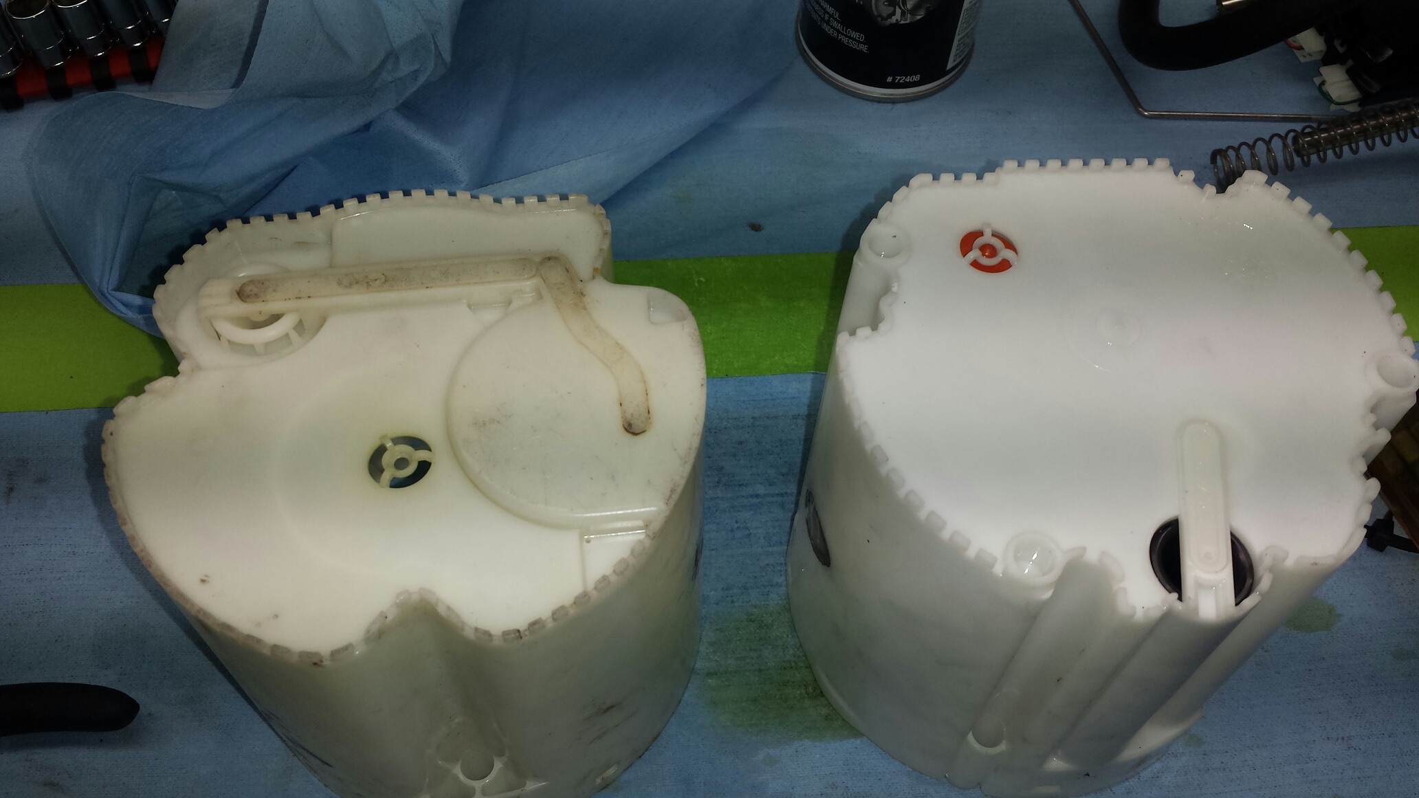

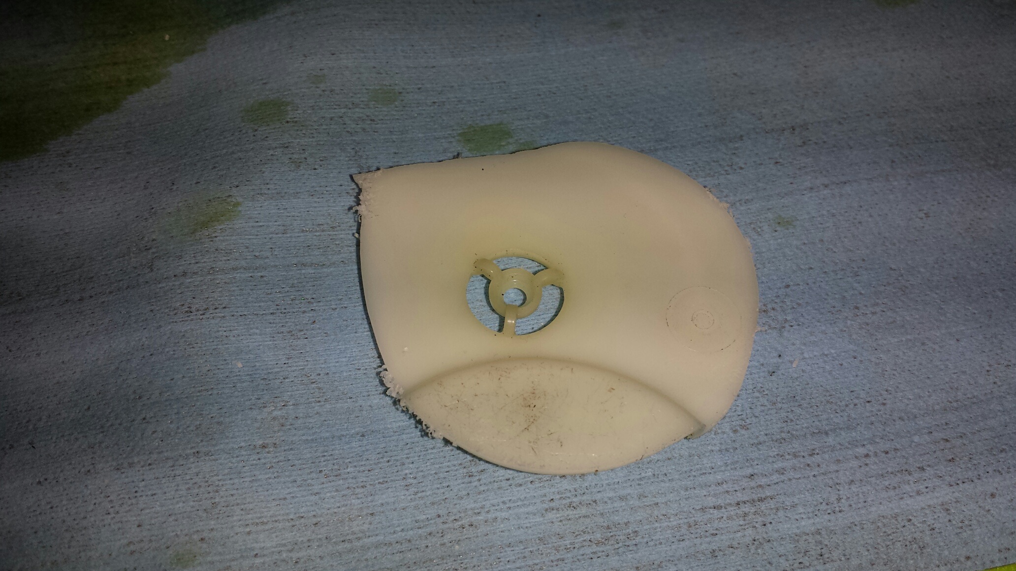

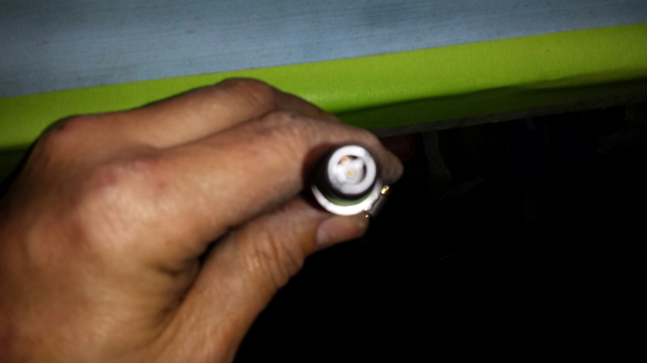

6.2 turbo build-image.jpgAttachment 72100

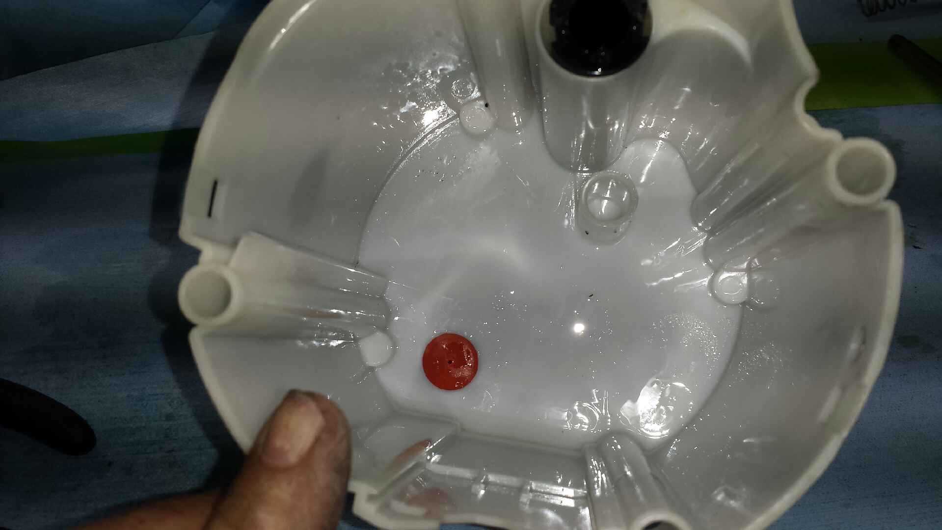

6.2 turbo build-image.jpg I install a second one way check valve in the bucket to get more fuel in the bucket faster.
