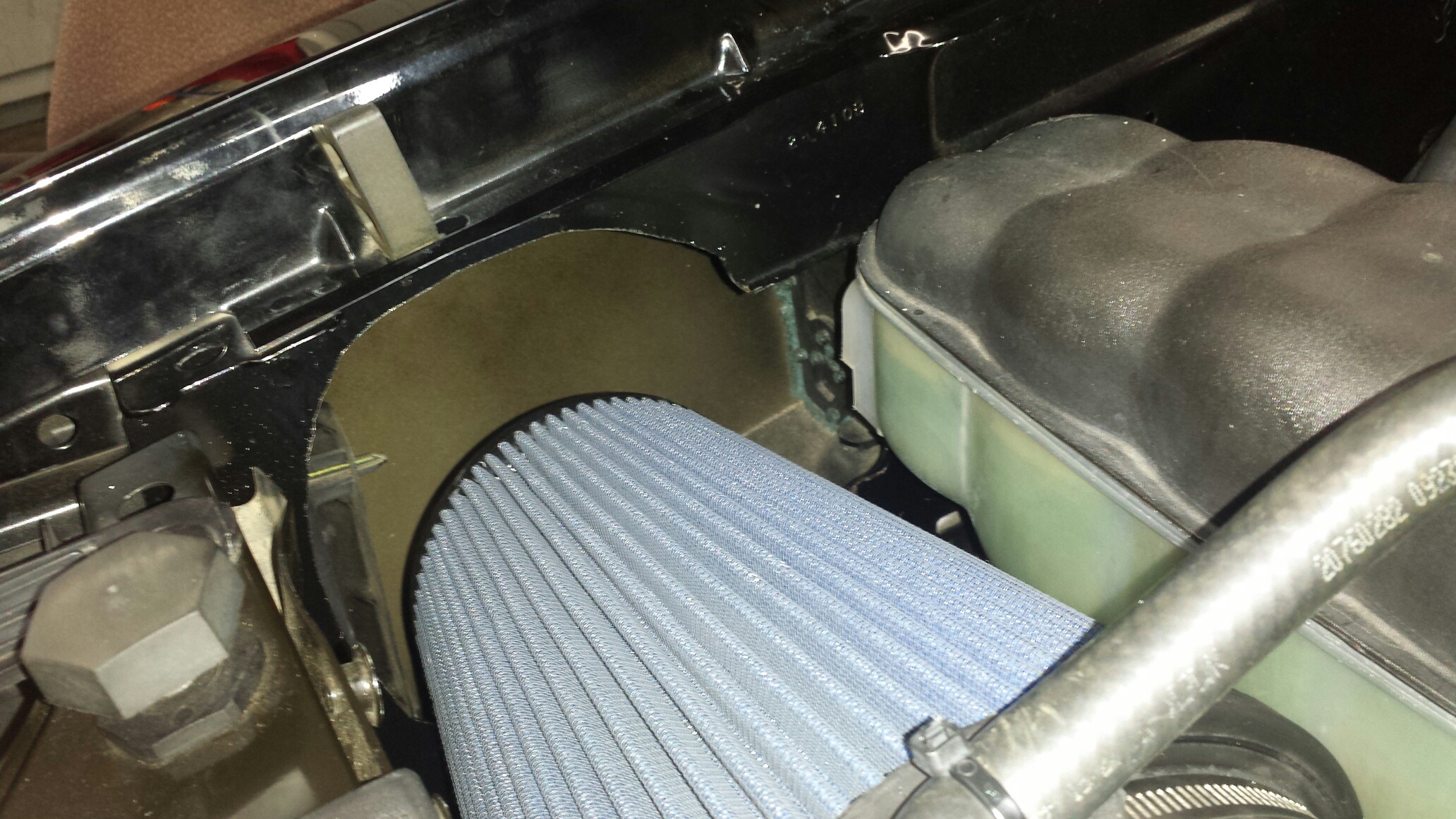

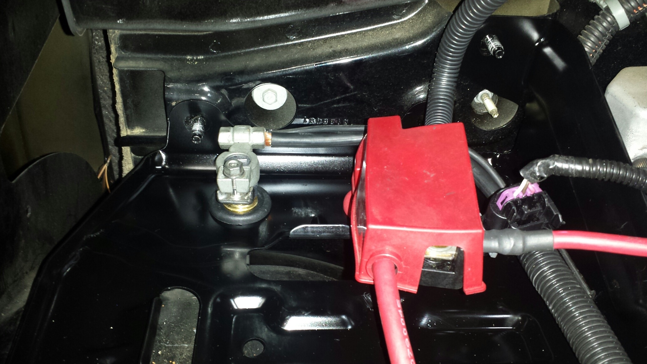

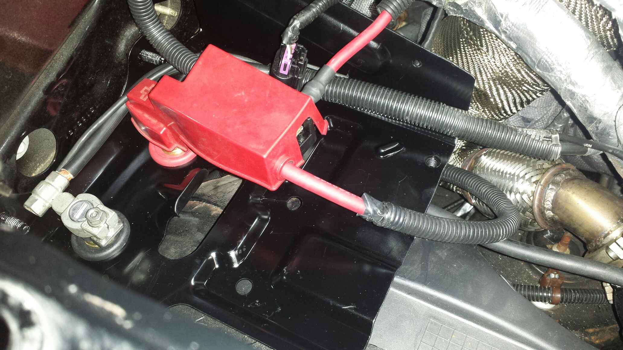

Guys I got the air filter installed and started to relocate the battery. Under the hood in the old battery location I shorten the battery box and install the two battery firewall pass thu. Going to remove the bed and start the install of the battery box and cables. Plus installing the new fuel system. I have a few pics of the work done so far.6.2 turbo build-image.jpg
