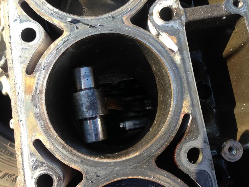

Couldn't reuse the mani since it was loaded with bits so we took some stress out on it with a desert eagle .50 cal. .

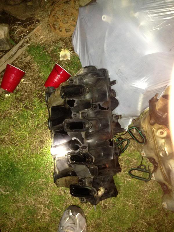

There's no doubt the 5.3s are great running engines , but going from one to a 6.0 especially in a heavy vehicle is a big difference . From the deeper idle tone to the extra grunt on the bottom end .
Now thanks for the warning on the cam gear , but I don't want to scare all the peeps with 5.3s , the 183k 5.3 that was originally in my truck was fine , I opened it up to do a cam swap and all was well , but I did replace the timing gears and chain while I was there . So my advice like yours is if your going to cam or force feed an engine def replace the timing set .
Btw you don't have to drop the front diff to do it ,only if your going to replace the oil pump , then you can just loosen all the oil pan bolts and gain enough clearance to do
