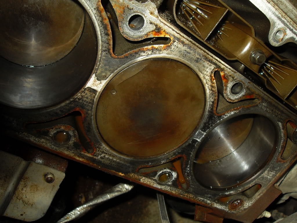

Tore down the top end tonight, this is what I found on the drivers side (the side with 3 holes of no compression). Piston #5 has a crack in it, and pistons 3 5 7 can all rock pretty easy within the bore, so I'm assuming the rings are shot, although the cylinder walls look good. I'm going to pick up an '06 5.3 this weekend.

nice crack!!! what about punching the 4.8 out???

Take the pistons out and you will see what happen to 3 and 7. Ring gland broken.
