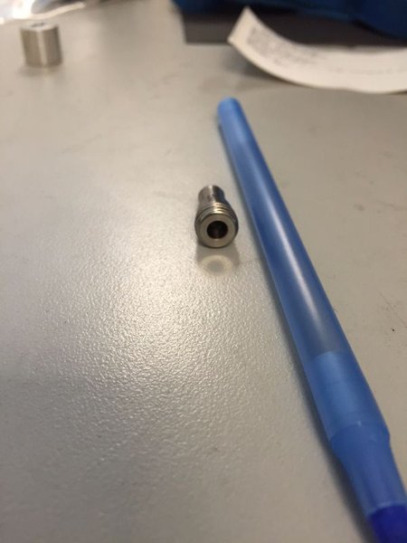

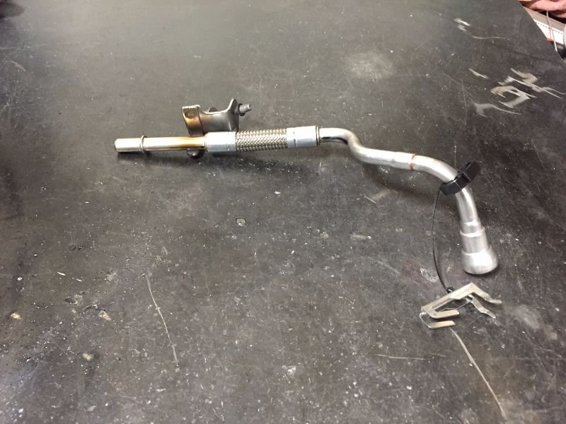

Do you have any other pics or info on that fuel line. I couldn't see what was different on it.
here are more pics. the check valve with the 4 pin holes was in the fuel line,which really slowed down the delivery. that valve has been eliminated and now flows straight through.
