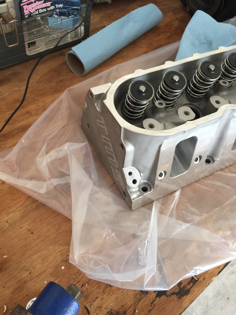

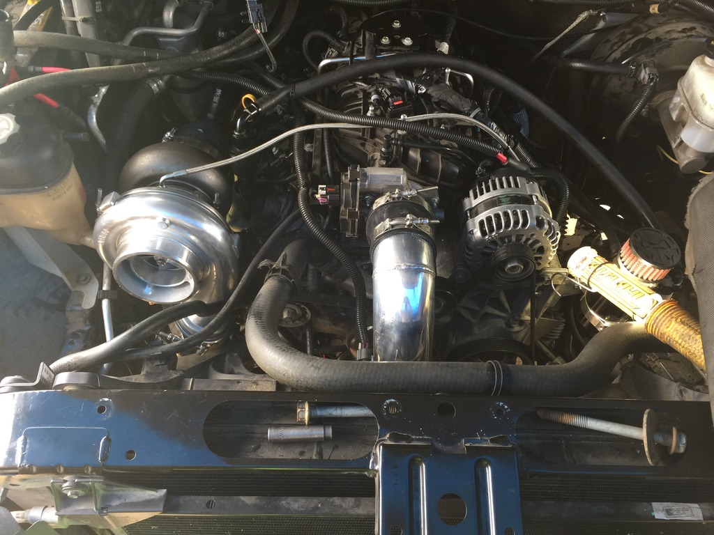

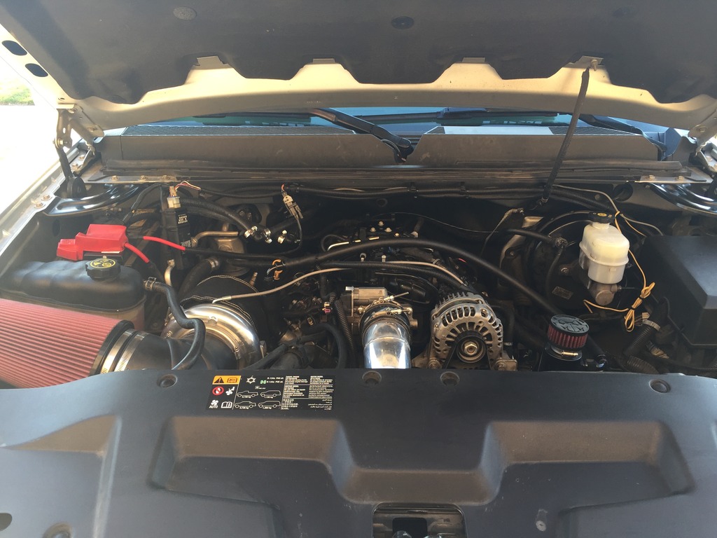

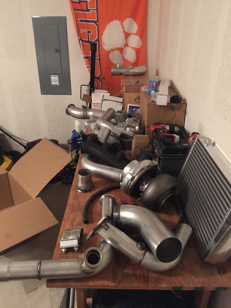

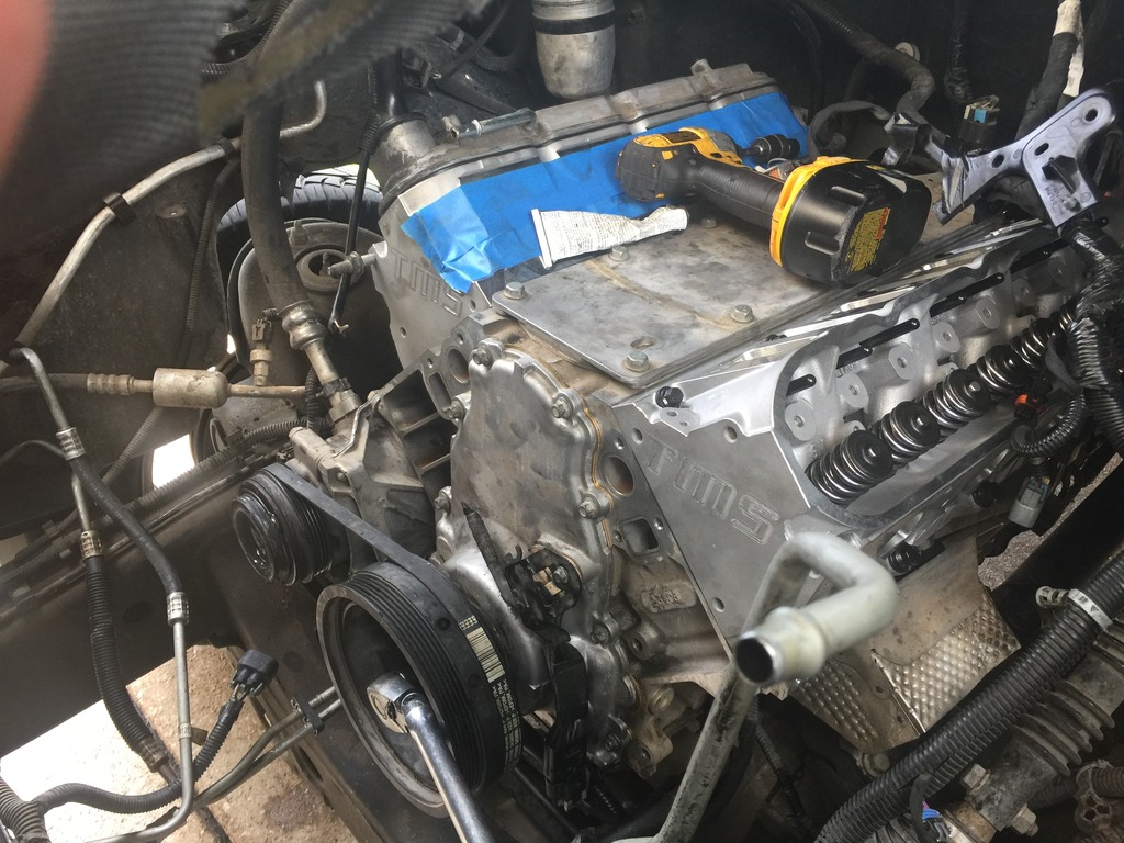

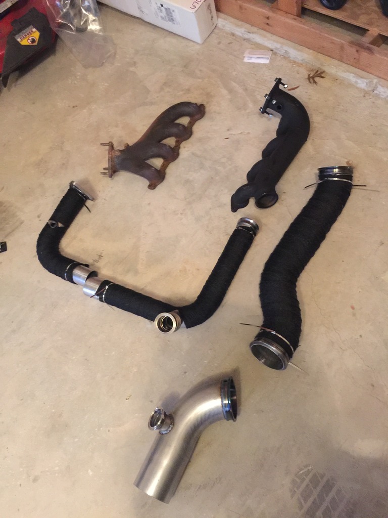

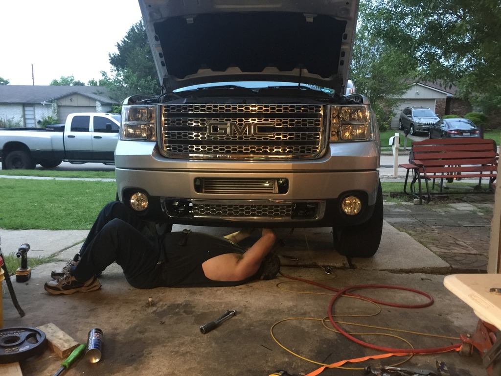

I never started a build thread on this thing because I didn't know how long it would take for me to actually get this this going but she's finally put together and running. Still a lot of bugs to work out with tuning but so far I'm happy with the results.
2013 l9h 6.2
Thompson Motorsports cnc heads
Tick performance stage 1 ls3 turbo cam
Kbracing turbo kit and an 80mm magnum turbo.
Truck is a flex fuel truck so I'm gonna test the limits of the flex fuel injectors (on 93) and then add some methanol and see what I can accomplish without upgrading the oem flex fuel system.
Here are a few pics I took along the way.

How did the crossover kit line up? I know I had to modify mine since it's 4x4 was hoping yours was a perfect fit.
I'm looking into replacing my current turbo log since it's leaking like crazy, and that one looks good!
Old Apr 12, 2017 | 08:33 AM
gunter96ws6's Avatar
Joined: Dec 2003
Posts: 333
From: Mckinney, Tx
The kit fit like it was oem, I was very impressed with the fitment. I was concerned going in that the 1.5" body lift would affect fitment bit went together great. The only thing the body lift affected was the coolant tank. I drimmeled on it a little bit and moved it a couple inches counter clockwise but I've since bought a custom tank from atomic.

Wow that's good to hear I might just purchase a turbo log, and try to fab up it up to my current crossover hopefully it won't be such a headache
Old Apr 12, 2017 | 03:57 PM
Joined: Dec 2003
Posts: 333
From: Mckinney, Tx
Does your truck sit like the pic in your sig? The angle on the driveshaft may be the issue with that lift.
