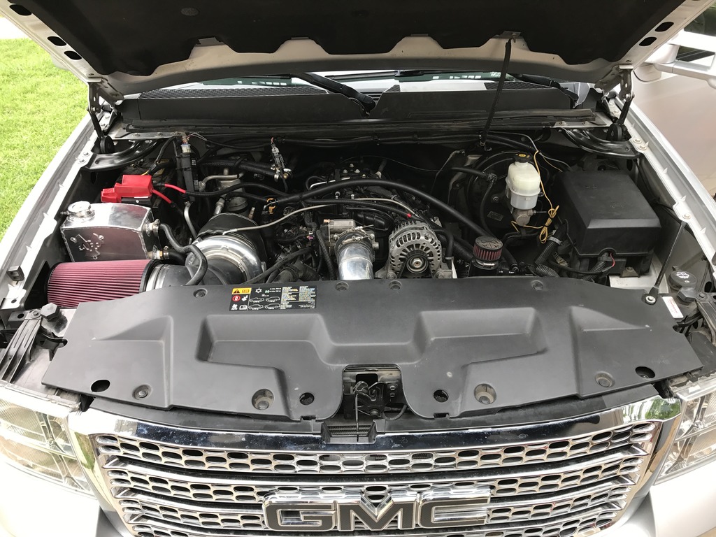

Big thanks to atomic for this custom coolant tank, makes things much happier under the hood and looks fantastic!

Looks good! Thanks for the feedback!
You can get a similar elbow from siliconeintakes.com I believe.
how do you have that mighty mouse can plumbed?
To each valve cover.
