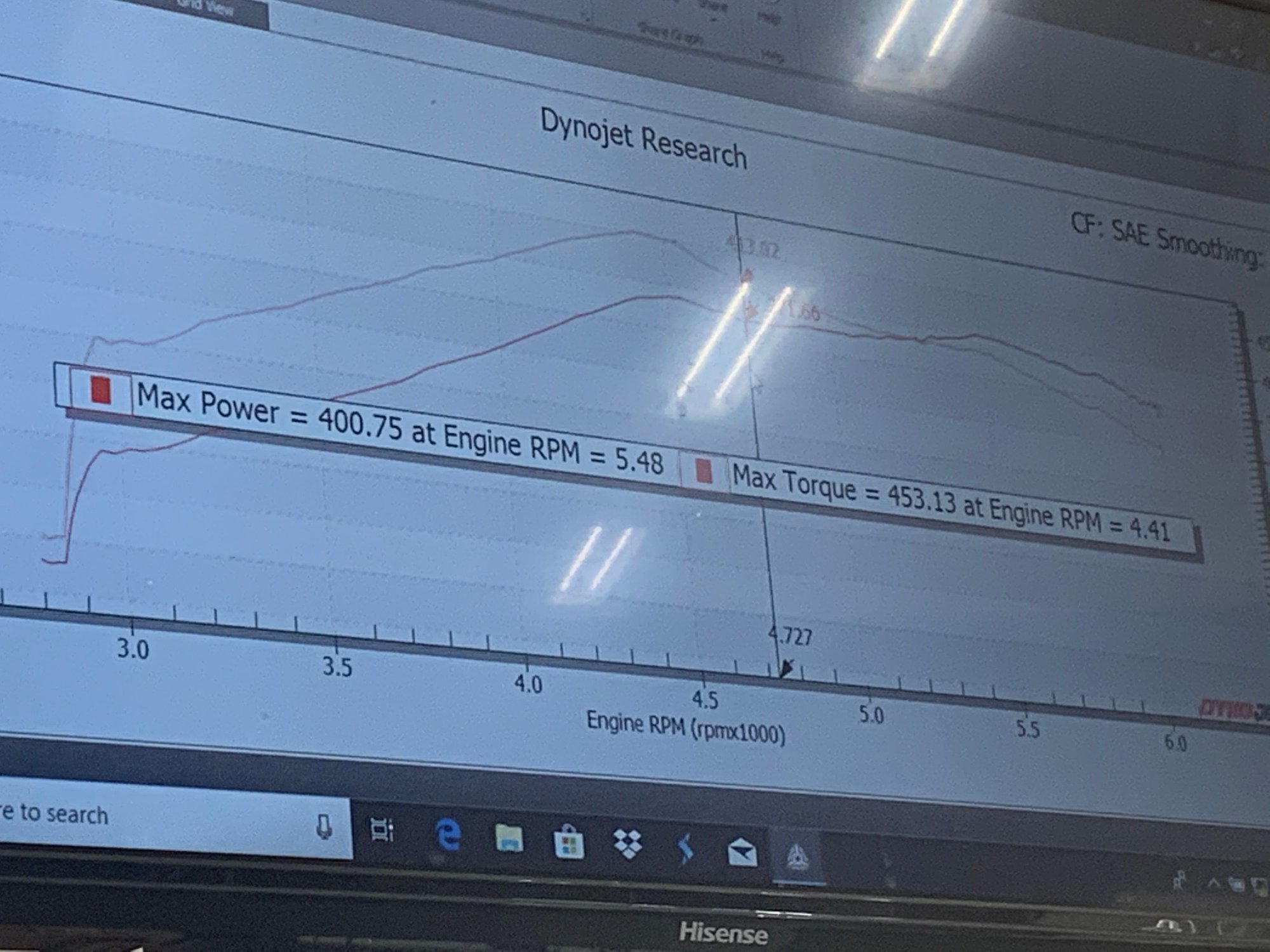

So the cam was degreed and cam gear changed.
the over advanced code has gone away.
I had the truck dyno tuned again and with a now installed 3 bar map we found the truck was only seeing 6 lbs of boost. I have a mechanical gauge on its way to replace the digital one that is clearly not reading correctly.
the truck on 8-10 lbs made almost no more power.
417 on 10 lbs
here is the graph
Sorry for the reflection
Does anyone have any suggestions? The boost curve also follows the hp curve. Peaks, then dips and flattens out.
the truck detonated in the dipped area after the spike
Old Mar 26, 2020 | 08:13 PM
FFDP's Avatar
Joined: May 2014
Posts: 5,282
Likes: 600
From: Rogers, MN
I want to see the tune file and data logs from the pulls or street driving.

Hopefully you have your plugs gapped right.
.025-.027 would be ideal.
I’m with FFDP. Let’s see the tune and the logs. At that boost level, you should still be able to run 17-18 degrees of timing safely.

I don’t have either right now but I’ll get them. I’ll post them in a couple of days
I do have full exhaust including a catalytic converter with a 28” magnaflow muffler.

Just a cat? How far down the downpipe is it?
Single cat I'd be worried you've got a restriction, and worried the cat may or may not be melted at this point
I agree. I had it taken off yesterday and the truck feels better. I’ll get some logs to see if we have detonation in that same area of rpm on the street.
