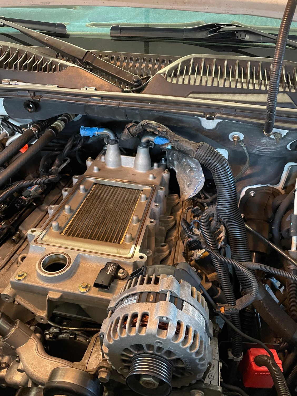

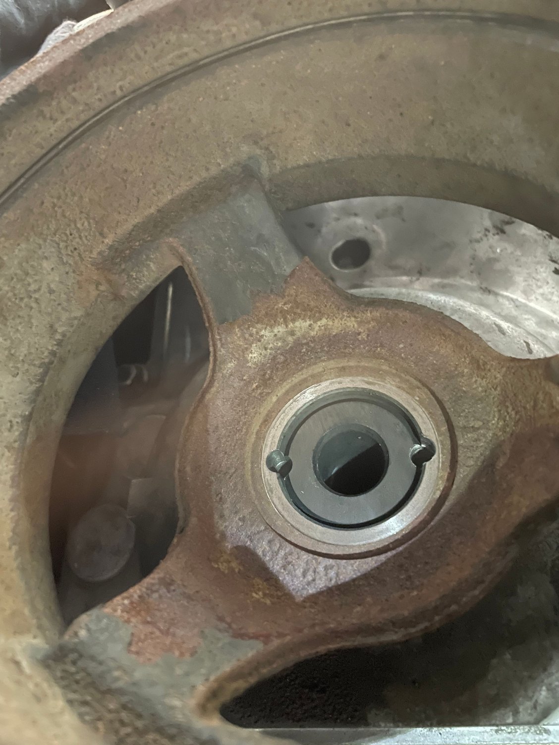

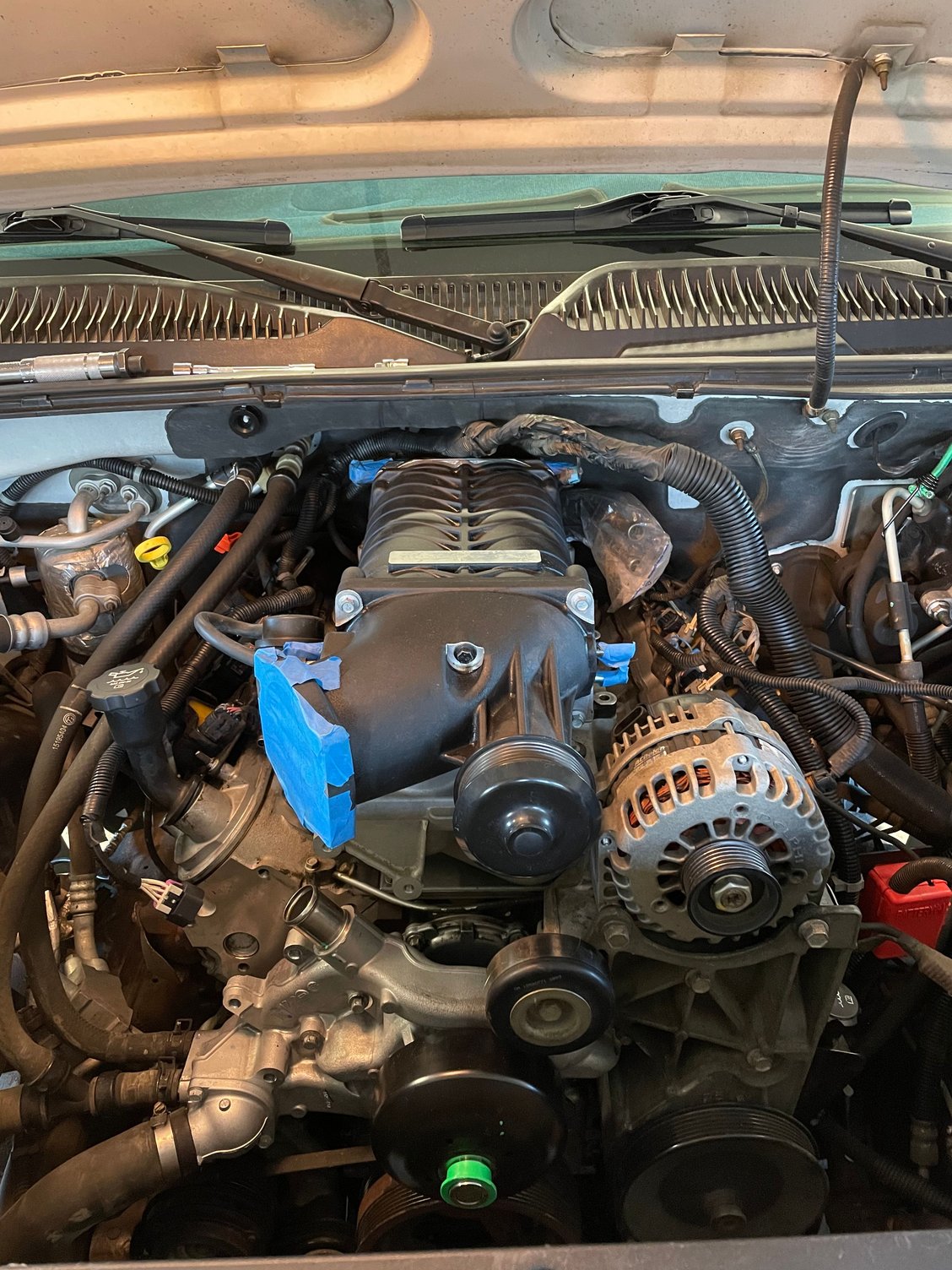

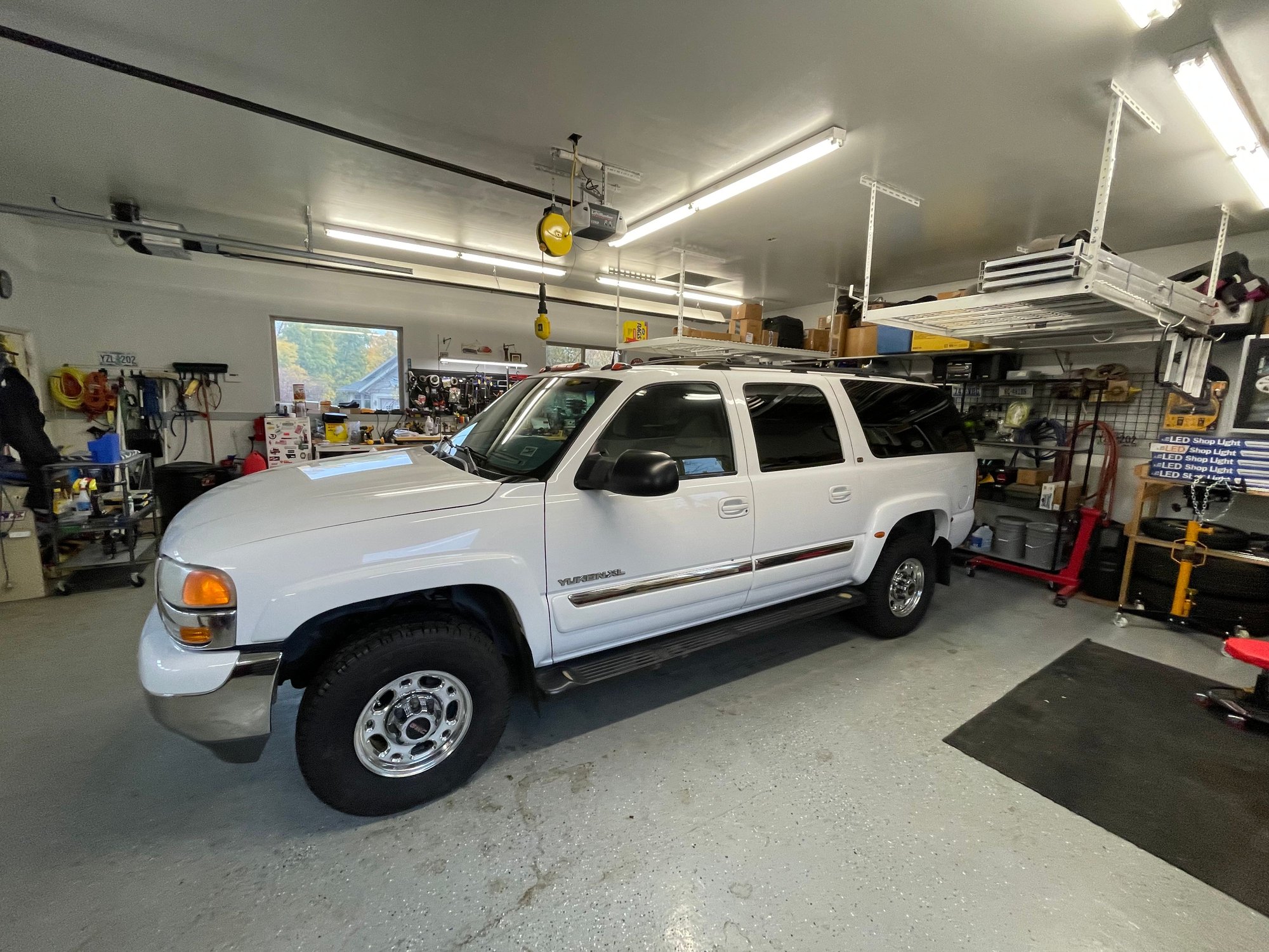

Adapting my Roush TVS1900 kit for GMT900’s to my GMT800, in this case my 2003 Yukon 2500XL Quadrasteer.
Extra stuff needed and acquired:
NNBS water pump
NNBS fuel rails with removable crossover tube
TB adapter
MAP or TMAP sensor and adapter harness
Fuel injector adapters
Fuel system plumbing stuff if you have a return style
Everything is going pretty good, but the fuel rail and associated plumbing is a little messy. Going to start with using the C5 Corvette filter / regulator. My junkyard fuel rail was cut before the quick disconnect fitting so I had to adapt using an AN compression fitting and EFI quick disconnect 3/8 fitting. The feed and return lines would be kinked if I don’t offset the filter / regulator, so I’ll deal with that.

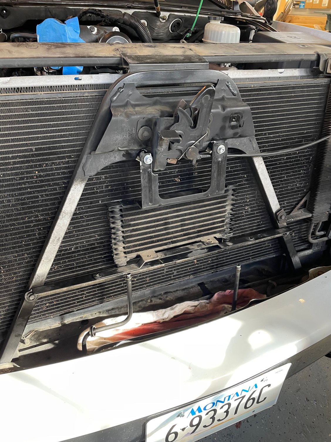

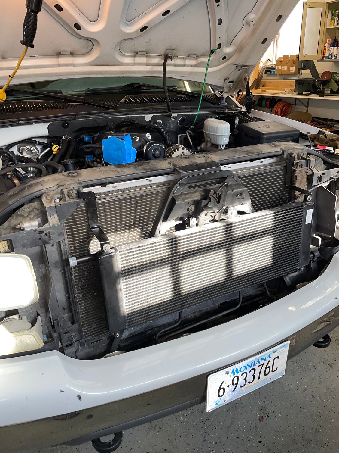

My first question is if the trans cooler is directional, or if it has an internal thermostat? To make room for the water to air intercooler heat exchanger I had to get creative. I turned the OEM trans cooler 180 and plugged the lines back in. Will this be an issue? I was able to use the brackets from the kit to mount it, but I did have to trim one of the trans cooler mounting brackets and use spacers to take up the offset distance to the OEM mounting holes. Also had to do a fair bit of trimming on the back of the grill.

Originally Posted by shakenfake
I've never seen a quadrasteer yukon before. did not know that they existed
Indeed they do, 2500 3/4 ton no less. I have technically owned 3 previous to this one.
NNBS water pump
TB adapter
The trans cooler is not directional and does not have a thermostat either.

Originally Posted by strutaeng
Nice! Those Quadrasteers are nice! It's a Dana 60 rear axle, right?
Correct!
I bet you can park right next to the Smart cars with that Quadrasteer turning radius engaged!?
Yeah, the 130” WB lends itself to some tight circles My 2500 Silverado with QS has a 143”WB and the difference is very apparent.
Thank you, that’s what I needed to know!
