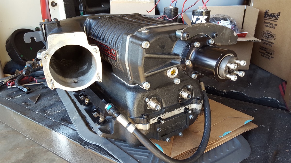

I have a 102 bolted directly to mine, and it is ported as well. See pic and the lower set of bolt holes.

Did you bore it out yourself Richard? And if so what tools did you use?

No, I bought it used from a guy who had it ported by NewEra Performance somewhere in the northeast (I think). Im assuming they used the same tools as one would use to port heads.
