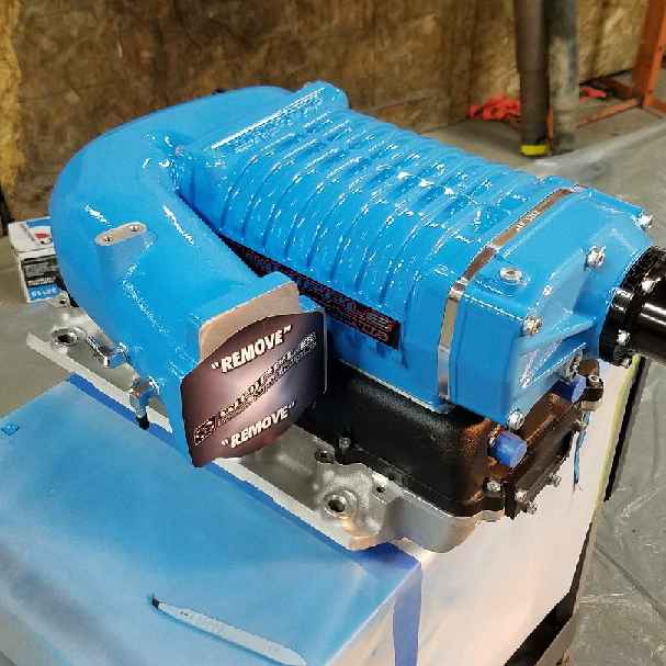

It’s the 2.3L for a 2009 Sierra 6.2L. Do you have any pictures of what you did to modify and make the 102Mm fit? I’ll link a pic of my whipple

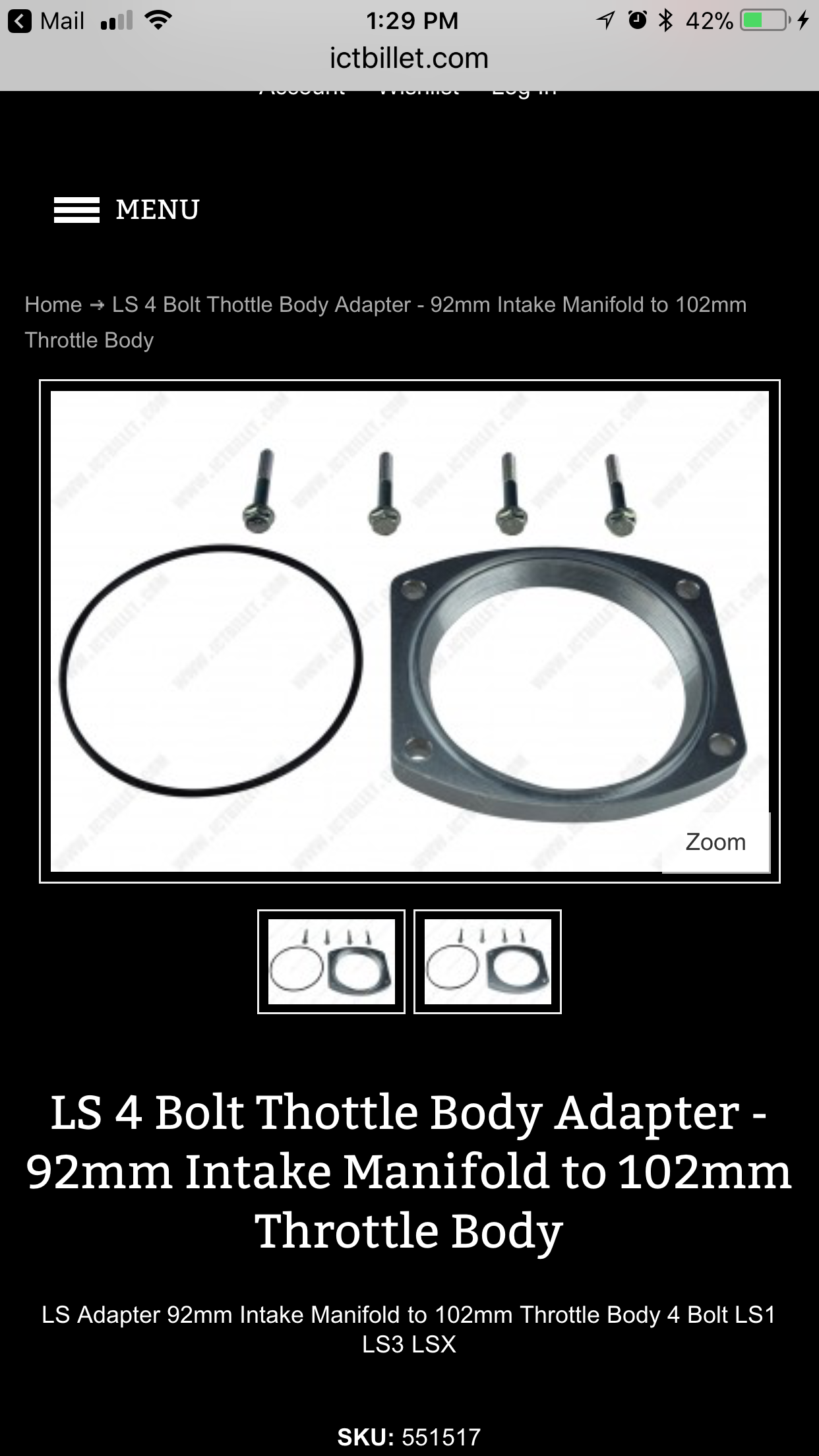

picture of my whipple, and this is an adapter I ran across I am wondering if something like this can be used.

You need a 3bolt to 4bolt adapter.
I think the tricky part is going to be the 102mm as most adapters are 75/78mm to 92mm adapters.

My stock 92mm truck TB is 4 bolt and the whipple is designed for a direct bolt in with my 92mm, I’m just wanting to install my Nick Williams 102mm and whipple said I need an adapter

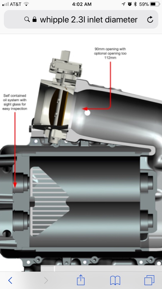

Downside is that the whipple inlet is still not anywhere near 102mm so the gains aren’t true.

This is the Drawing I have found of my Whipple 2.3L 140AX since I am away from home at the moment.
