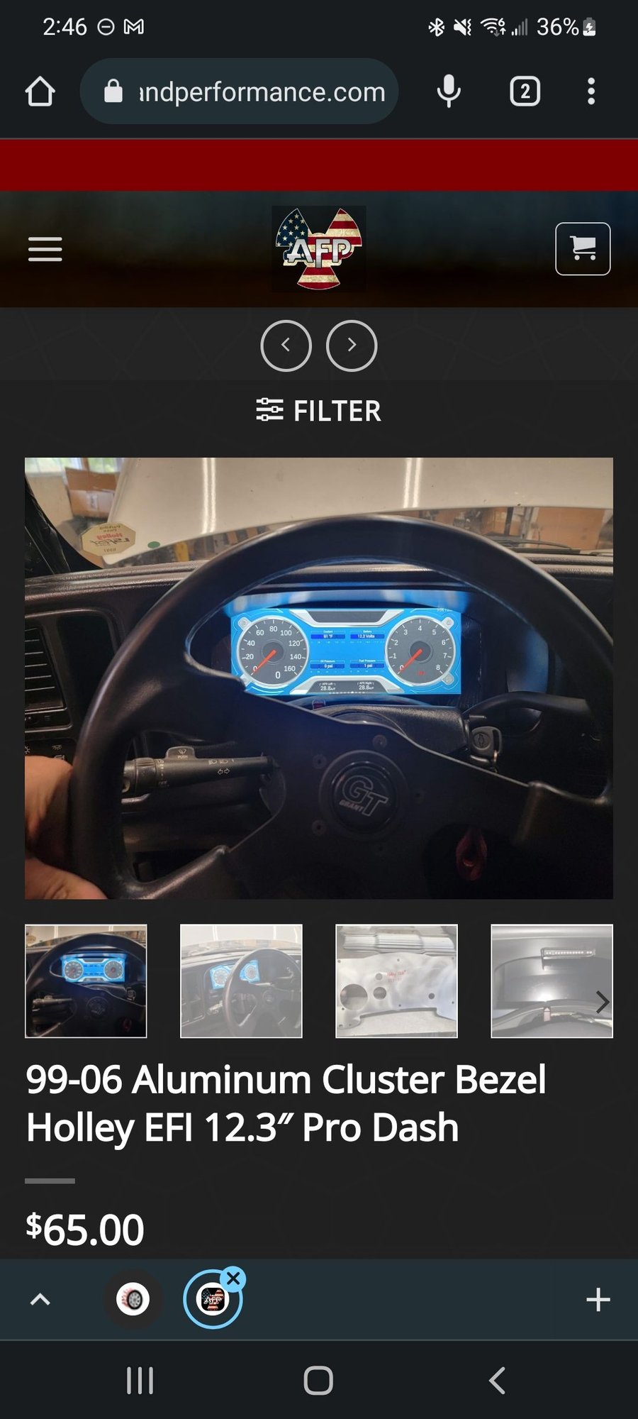

Originally Posted by ALL ULL C
Been there myself thinking about the big’en dash but went with the 6.86”.
Atomic I think had a picture of what the 12” looks like in the NBS dash as I think someone used one of his plates and just trimmed the plastic around the gauge cluster, I don’t see the pic showing up under Atomic’s post on my iPad though
https://www.performancetrucks.net/fo...l-dash-558142/
Here is my truck with my 12in Holley dash with no trimming: https://atomicfabandperformance.com/...-3holleybezel/
I knew I should have went with the 12”!!

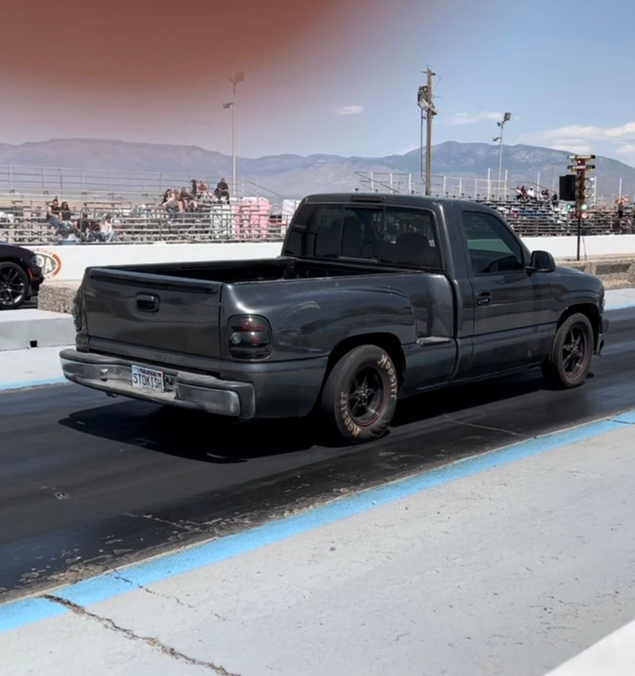

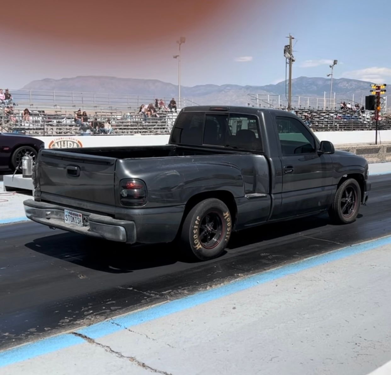

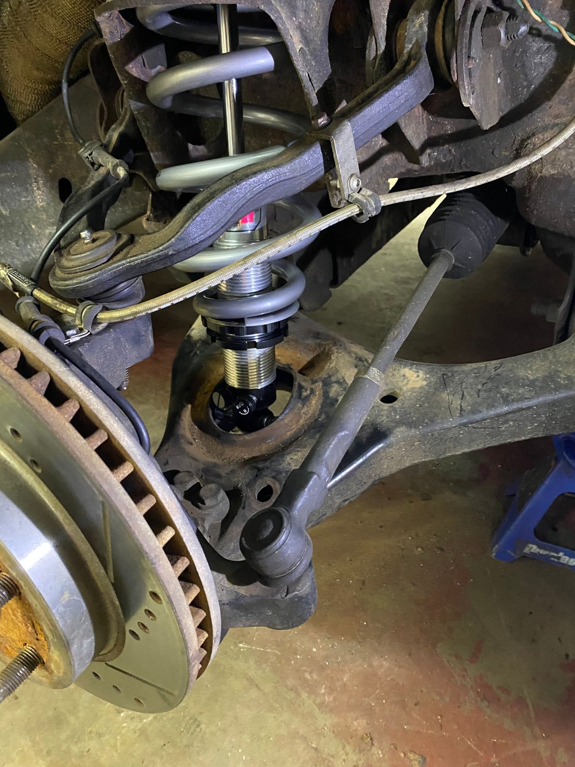

I finally got around to swapping the front coils and DJM drop shocks to the QA1 double adjustable setup and the adjustment is amazing. I should have some track time next month but the other pics below are how it responded at the track before and you can see there there isn’t much front end rise (wasn’t maxing out the shock, just no rebound).
I'm running a coilover conversion from AFP on my 4x4 with double adjustable viking shocks. It's amazing the difference in these things getting rid of the torsion bars. Keep up the progress reports. It's awesome
