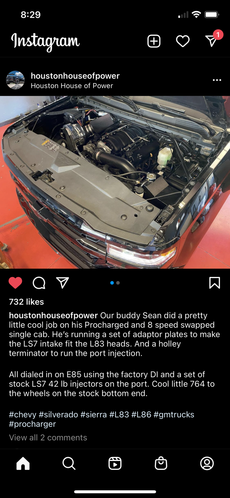

Read the caption below the picture. I don’t know the details but this sound like a cheaper option for fueling. Buy using a LS7 intake on a L83 for port injection.

You know I had heard of that a few months ago... LS adapter plates to use LS intakes on an LT. I didn't know that you could keep the DI too though. If that's the case that is a very very good option. I understand LS3 manifolds are killer as well. Thanks buddy think I'll research a bit more. I'm driving my neighbor out of his damn mind because I'm taking so long. Just been paying off debt so I can go crazy. The '16 still doesn't have 20k mi on it.

Only the ls7 intakes work on the di engines with the adapters because the ports pretty much match up the same
