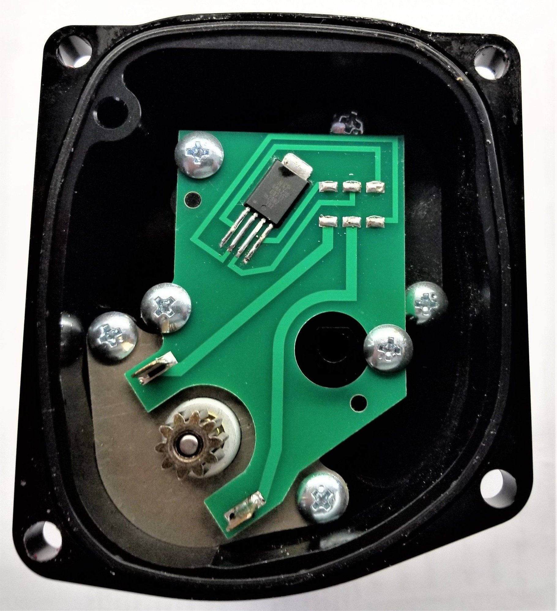

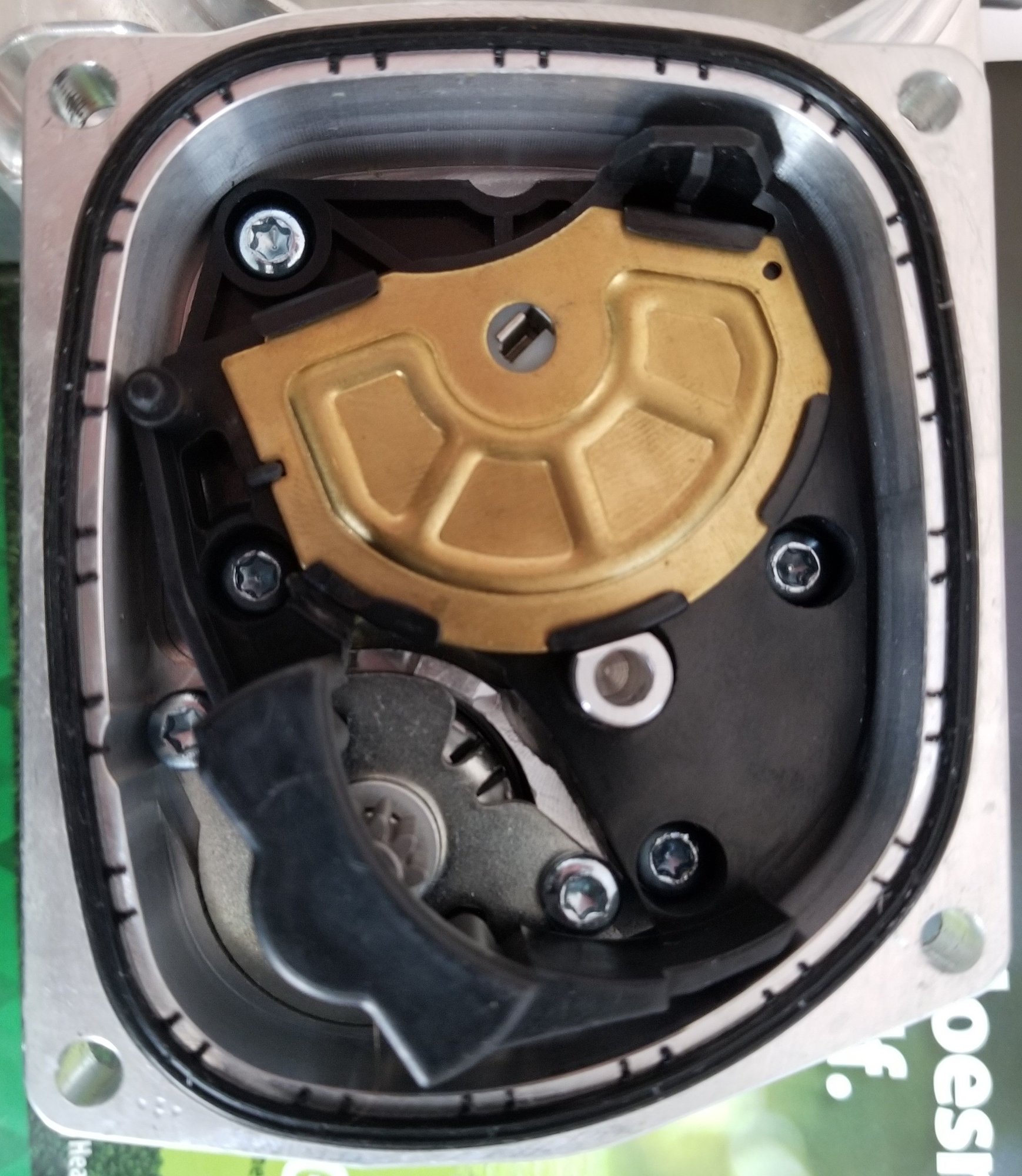

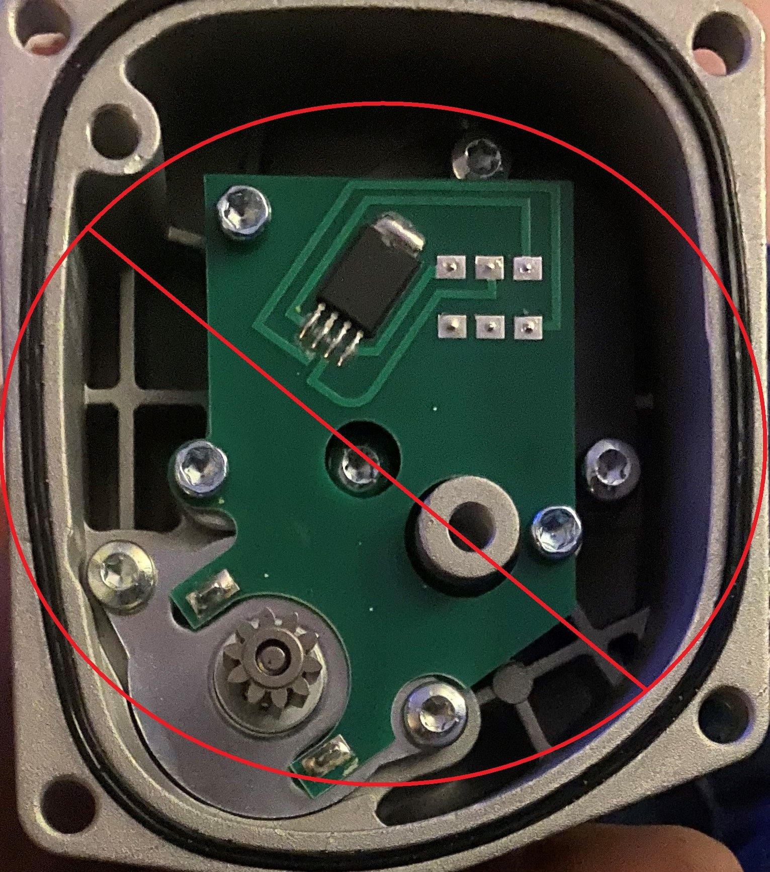

102's or LS3 90mm clones that use magnetic sensors are not compatible with the truck TAC module. For one thing, the 5V reference circuit is inadequate to power the magnetic sensor.
Nick Williams 102 works with the gold version X-Link. I think the issues with the 102's at higher boost levels with a blower are due to the current draw. Typical max allowed current is 6 amps. Exceed that and the throttle will shut down.
Here are a 102 and a LS3 clone with magnetic sensors. Last pic is a 102 that uses a contact type sensor as in GM TBs.
