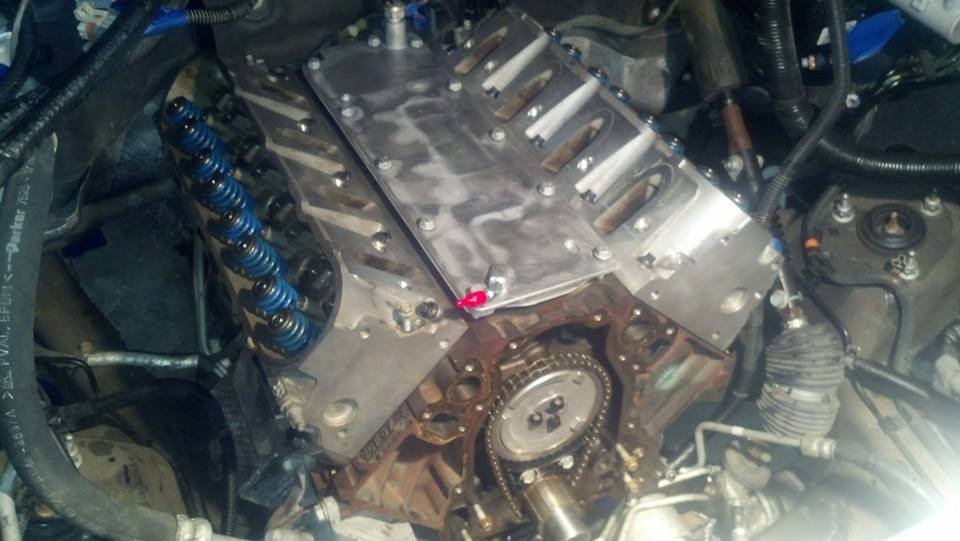

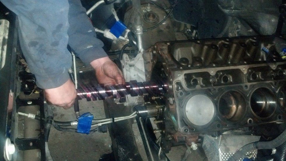

I was doing some reading and came across that a lot of people recommend changing the stock oil pump after deleting dod to avoid pumping the pan dry? From what Ive read the stock oil pump is a high volume pump... I was all set to order a standard volume/high pressure pump for the weekend but started thinking about it more is it possible the stock dod pump would be better for a turbo application.... any input would be appreciated... stock? aftermarket high volume? high pressure? Thanks in advance... (im sure im over thinking this...)
Attached Thumbnails 08 Sierra manifold flip/build thread-1424350_750708888276571_1163002328_n.jpg   08 Sierra manifold flip/build thread-578147_750708938276566_728249475_n.jpg

Pumping a pan dry.
Add more oil to base level if that happens.
