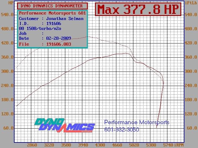

stock LQ4
stock 4L80E
stock TC
STS 60mm
93oct
275/60/16 Toyo Proxes S/T
TC locked up in 2nd gear on all the pulls on a stingy Dyno Dynamics
6psi ~16* timing
tune i towed with
ran a 13.2@104 on that setup
9psi ~14* timing

I gotta admit I'm a little underwhelmed by the power numbers the turbo's are putting out at moderate boost levels. They clearly have more potential when you crank it up and go for the gold... but at about 10# where I would most likely be living they dont seem all that impressive compared to their counterparts. I wonder if thats a function of having such an inefficient exhaust system compared to what the belt driven guys can run...

you gotta take dyno numbers with a grain of salt.. Trap speed is where your power really shows up.
Different dynos will throw the numbers compared to another. and turbos are load bearing, so some dynos wont let the turbo get to full boost.
Dyno dynamics to say a dyno jet is a 15% difference.
so my 440hp would be roughly 505hp on a dynojet.
