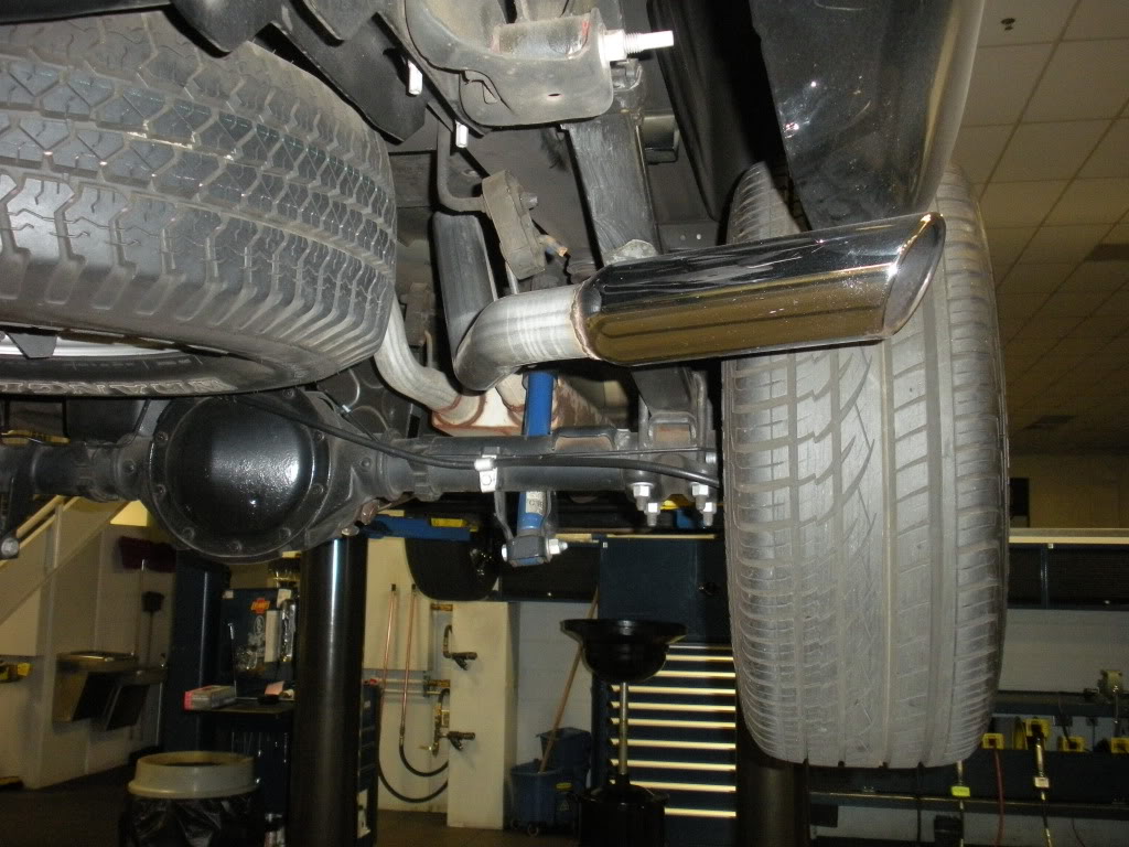

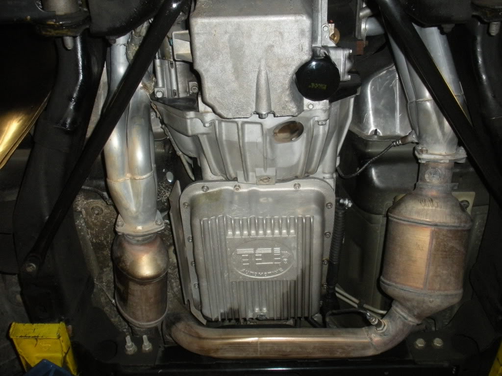

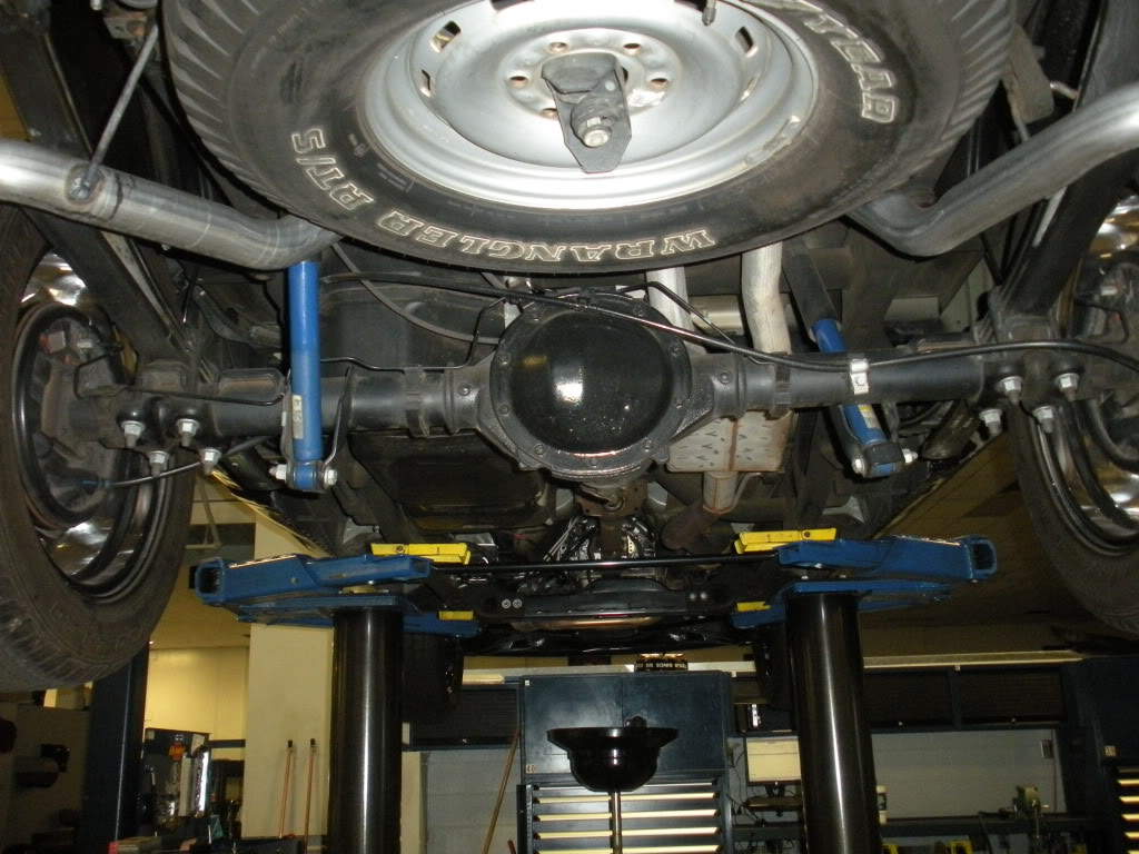

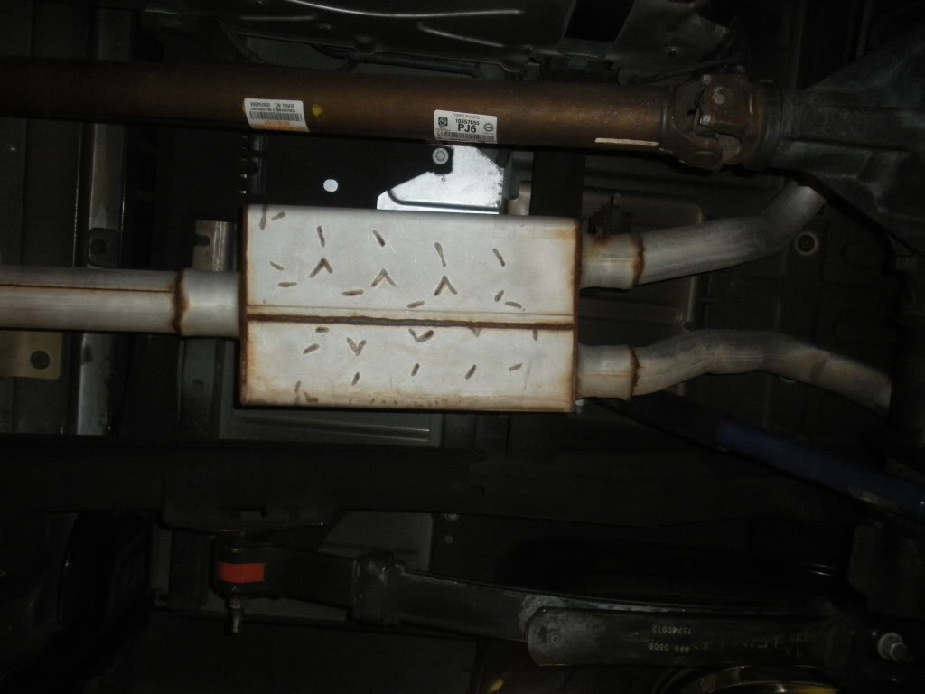

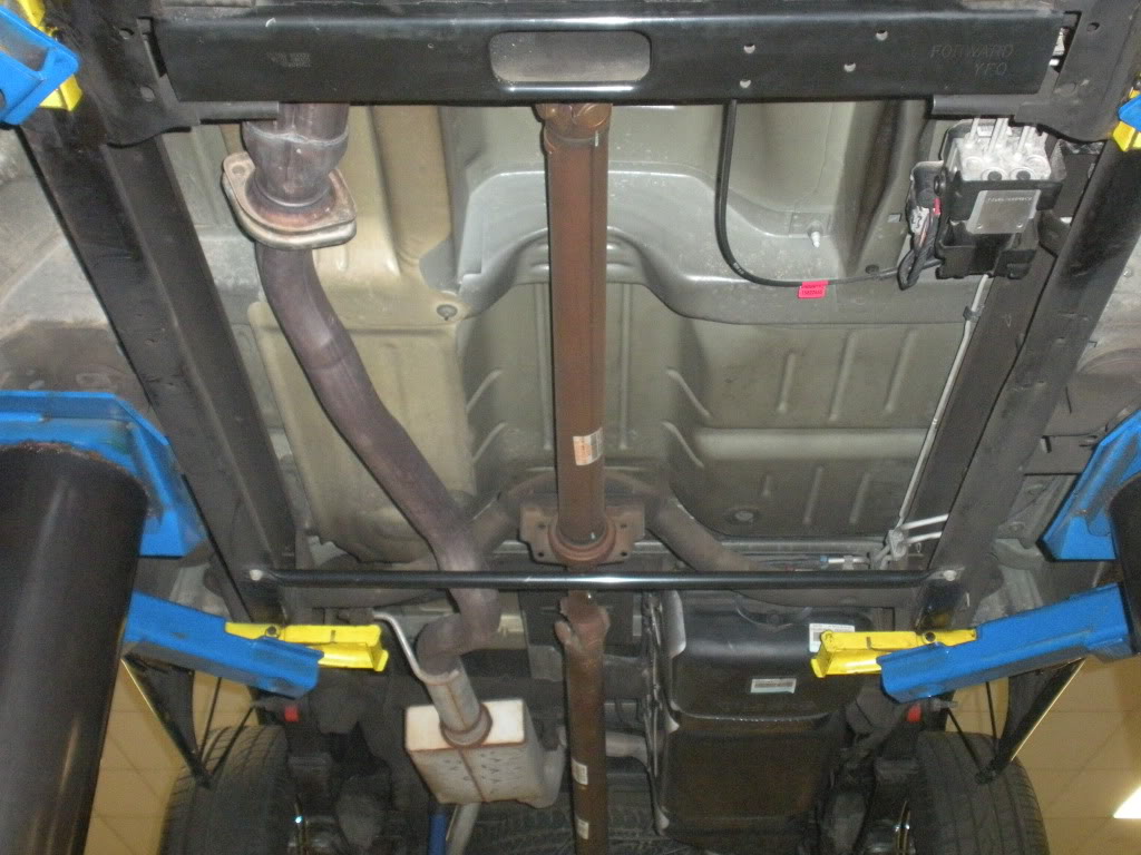

Originally Posted by black00chev
What is your exhaust setup currently? The one you are thinking about above would definitely help out.
I have long tubes into the stock y pipe with the stock cats into a spintech muffler 1 in 2 out with dual tips

I just did not have the time and money to build it how i wanted when i put the long tubes on so i went with this. also i was not aware that i could remove the cats delet the rear o2 sensors and still pass emissions at the time either. Any one have a opinion on how i should set up my exhaust next time around? the only problem i think i may have is that the Long Tubes i have only have a 2.5 inch colector so i wonder if i can even do anything with that. they are Arizona Speed And Marine LT's

The 2.5" collector is ok, 3" bein ideal. Run none, or fake or highflow cats and 3" as soon as you can... Your setup now is more then likely choking you up a little bit.
