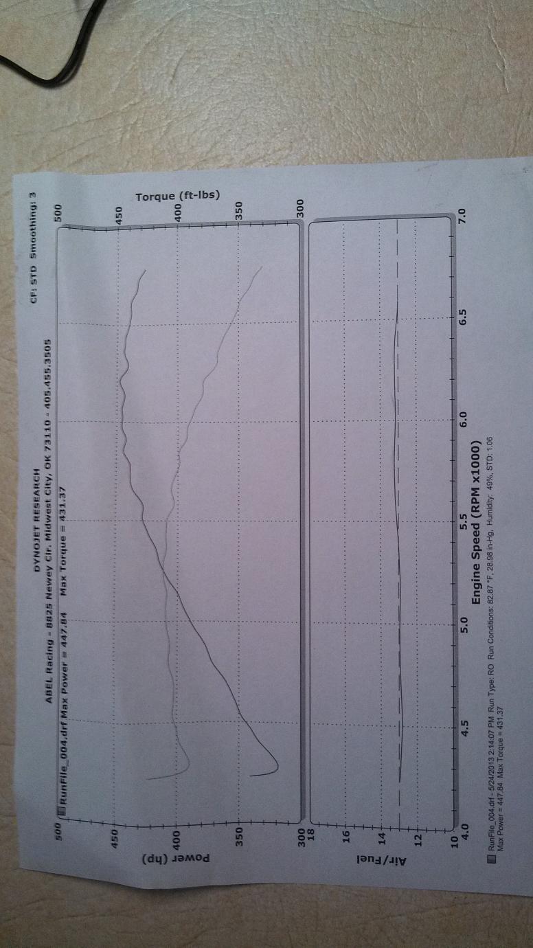

This is the graph. It's not the best way to display it but maybe you can see the info.

Posting a slip would be helpful also.
