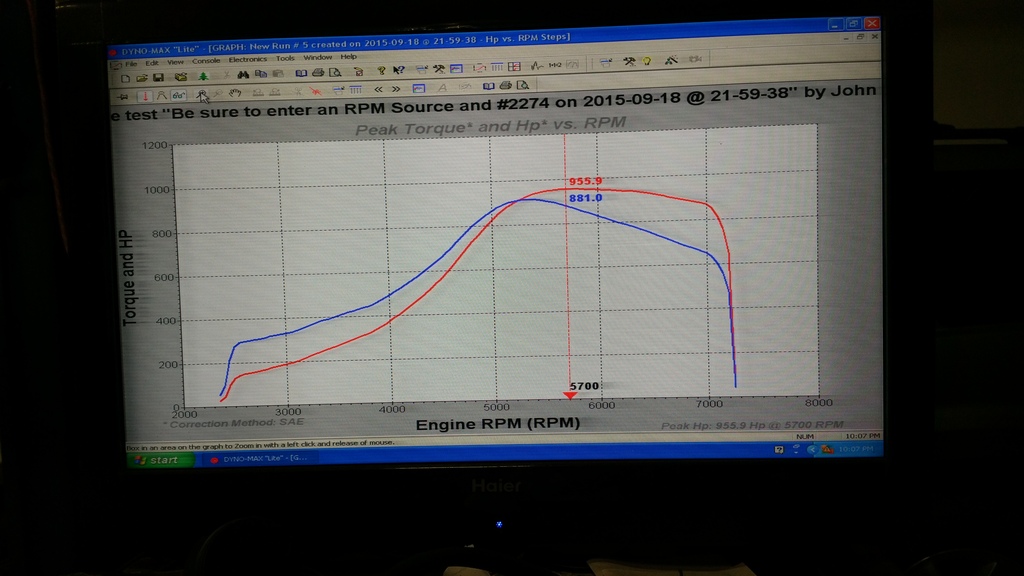

I'm happy. Pretty solid #'s for the dyno queen.

Nice numbers....holy crap i wish i could make that much hp, but i have no desire to boost my truck at this point..... Somehow i think itd be fun as hell tho...

Two words: beast mode!
That's a cast 80mm wheel? Which compressor cover?

Thanks man. Yeah, cast wheel, and stock non race cover. I felt like the power was dropping off in the higher RPM's at the track, but wanted to dyno it to see before my wheels arrive for a glory pass. I think the stock wheel is what's hurting me. Well that and my cam, it isn't ideal for a turbo setup. I might get one this winter from stock48 if I can pull some money together.

That is nothing short of amazing. A $900 turbo putting down 955 to the wheels.
I agree, the cam listed in your sig should pull higher than that. I'm thinking you've got the turbine wheel maxed out there. The v2 race cover could probably give another 100 hp over your stock cover, with lower IATs.

I think my IAT's hit 121 at the end of a run. I will have to look at a log tomorrow to make sure.
