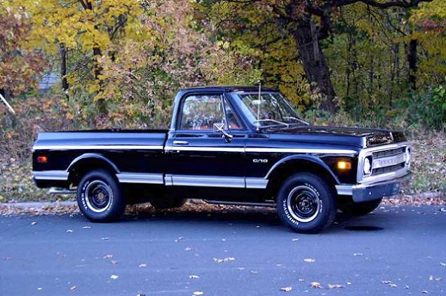

It feels just like it ran with the stock cam, other than the fact when you rev it up to 4500 or around there it keeps pulling and pulling. Very steady smooth power above 4000 RPMS, perfect for passing. I think any bigger cam would have been a bad choice for my style of driving. My gas mileage didn't go up or down either. Right at 22MPG on the highway at 60MPH. We have poopy gas here in MN as well. Any bigger of a cam and I wouldn't have been happy. I think the key to having a good street motor is to have the broadest, smoothest torque curve possible. Any bigger and it would have developed a lope, then comes a decrease in gas mileage, hotter temps at idle, vibrations, etc etc. If I want to go any faster I'll put in a 408 . Otherwise I'm trying to be practical with this thing and get decent mileage and good driving mannerisms. Just wanted a slight warmover on top of what the factory power was like If I want to drive a big lopey fast truck I'll drive this:
My '70 C10 SWB with a 500 HP 468 big block and 4 spd muncie. Brakes aren't an issue since they're full manual drum LoL
Joe
