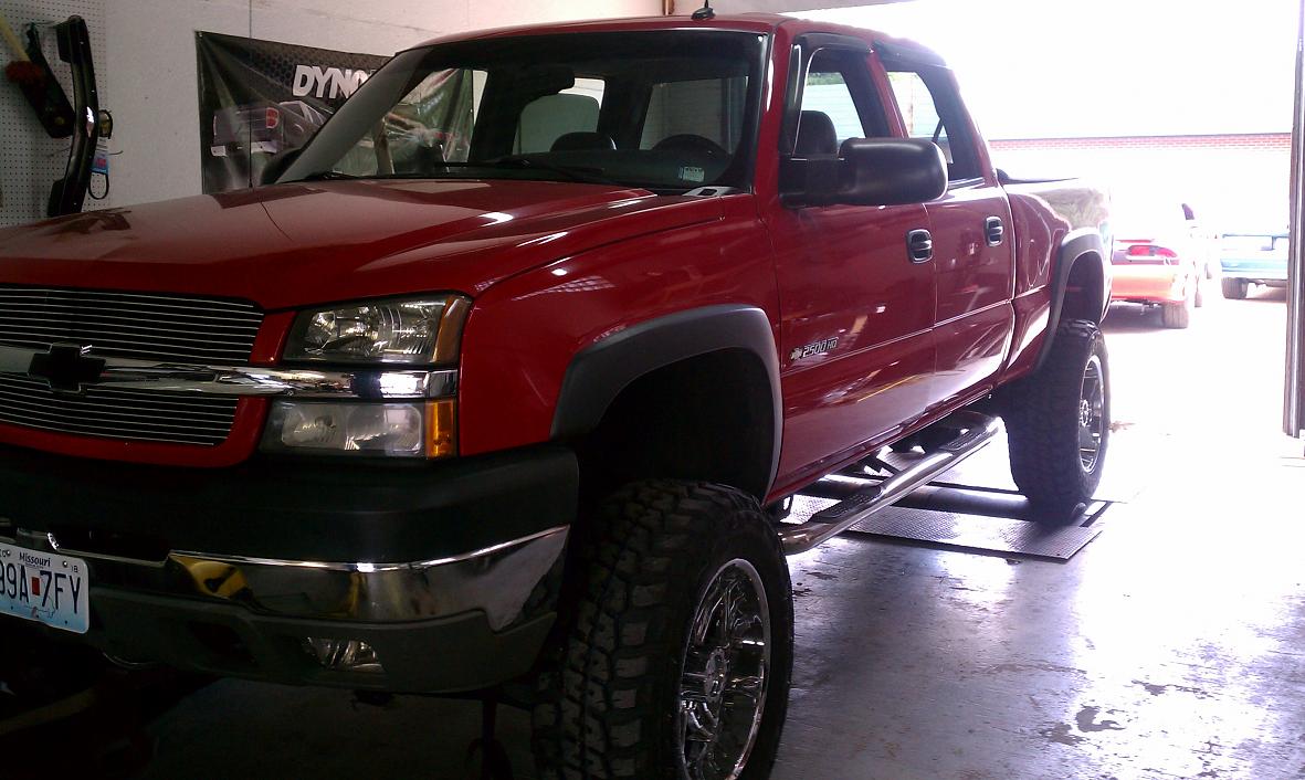

I just had to do it....LOL
The truck is stock except for the borla muffler and a street tune...
That is all the way down to the factory intake and paper filter with over 240k on the clock
only 245rwhp/280rwtq...puke!!
I was not happy! But, then again it is stock with 4.10's and 35x12.5-20's
so I guess it isn't terrible.
Now, the changes are coming...
220/223 @ 114 -.600 lift
Ls7 lifters
7.4 hd pr.
ported and polished 243's, milled to 60cc
ported oil pump
new chain
asp ud pulley
texas speed longtubes
magna flow cat-back
ported stock tb.
and the 4" cold air intake.
After these results, the tbss intake with 87mm ported tb. and x-link will go on for the real world "dyno test" ...
I have heard neg. results... But, I really hope with the increase in compression and the cam swap the tbss intake will make a positive improvement, worth the investment... We shall see!!!!
Stay tuned...

That's pretty good considering the wheels, tires and mileage. Looking forward to the results.

Those are decent #'s for the combo. My 2005 CCSB on 35's with 80k and similar mods made like 15 more rwhp/tq. Keeping an eye on the continuing results.
