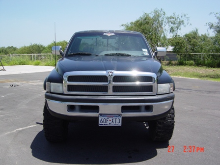

Default 2wd to 4wd 1997 Dodge Ram
I am pleased to introduce myself. I am from Texas and a proud owner of a 1997 dodge ram 1500 2wd. Well, not that proud, which is why I joined this site. I Will be converting the 2wd handmedown from my dad into a 4x4 monster. My plans include a D60 front from a 1994 f-350, 12" lift using leaf springs, an NP 231HD I recovered from a junk yard along with a 46re transmission from a 4wd ram. So far this is all I have gathered, I will be needing the help from all the members who are willing to assist and have better knowledge than me in this field. I work in the oilfield and have limited mechanics know how. I read alot of offroad mags and gather most of my knowledge from there. Please feel free to give any input.
