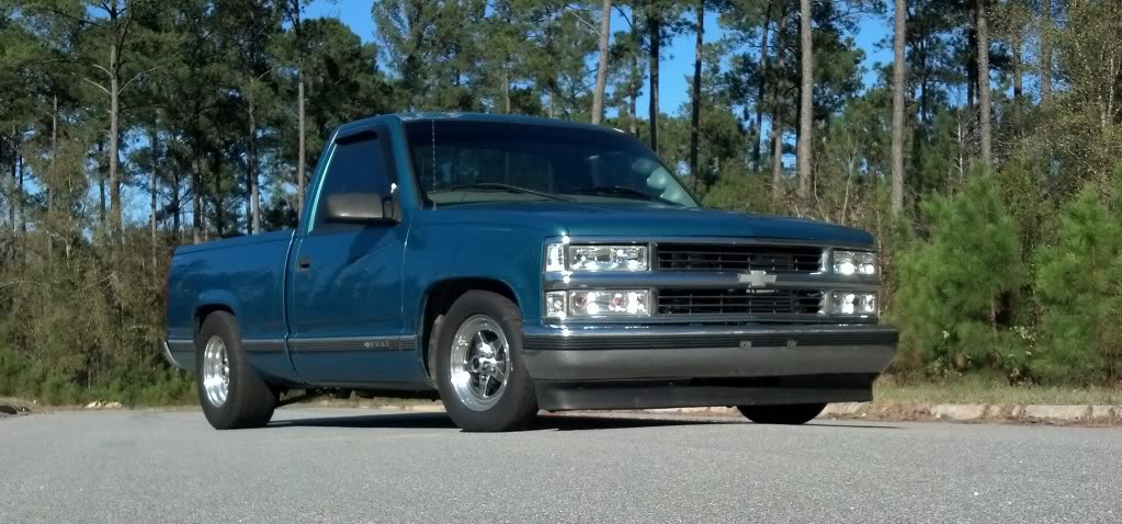

1997 chevy truck trying to get ideas on what is reasonable front/rear weight ratio
heres the truck and heres what it weighed today with me sitting in it (240 lbs). i already have a fuel cell in the rear but i still have to run the lines so the stock tank is still in the middle of the truck. also plan on moving the battery to the bed as well when i run the fuel lines. any other ideas?
edit:ABS an A/C are also deleted, power steering is going to stay
