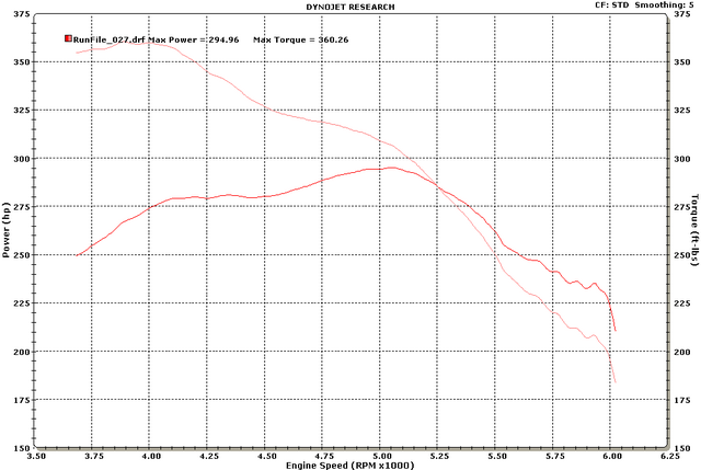

Your titan makes GREAT torque when it does flash to 2500rpms, I have driven my dads a few times. Going from 2500 to 3200 in the powerband. Are you making more torque at 3200 then say 2500-2600? if so then this will help. If your not which i don tthink you are making much more torque at 3200 then 2600(atleast to pay 1800 for) then it may not be worth it.

here's a recent dyno you tell me, hehe i really don't know if it'll help but the way it is now sucks, i dont have a 2500 stall now prob closer to 2200 off the line it barely even throws u back in the seat.. i think the titan gets it's top torque under 4k rpms.. specifically in the 3200-4000 region.. then it falls off
here's one of my dynos.. even after 27 dyno pulls in 1 hr the beast still performs strong
only lost 10hp and 12tqfrom when i started from heat soak
