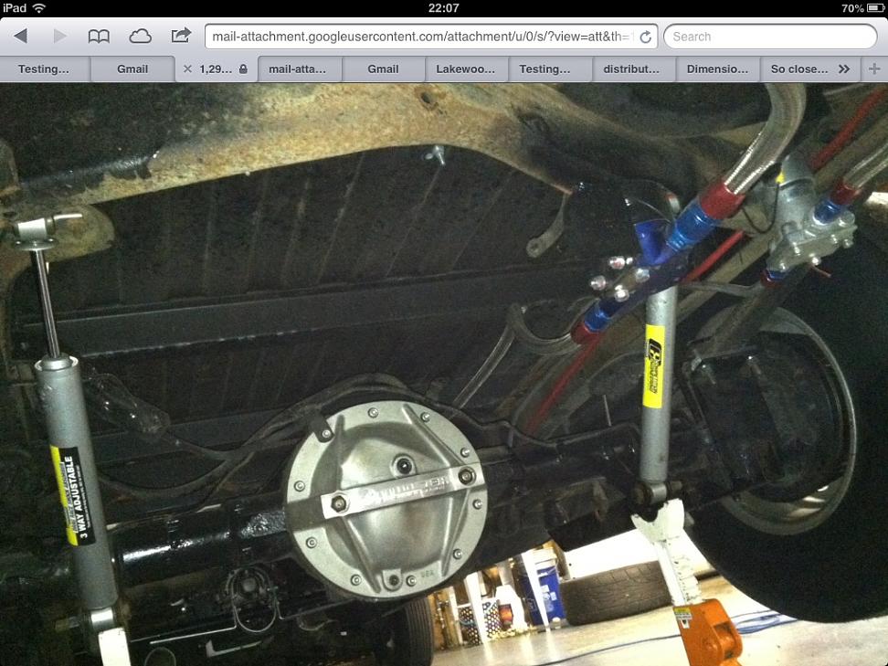

I think I had to much preload in my traction bars and my shocks were set on max stiff,so I adjusted the bars and softend the shocks.Tommarow my new driveshaft will be ready and then it's wait till sat.

Yes I always go through this on a build.

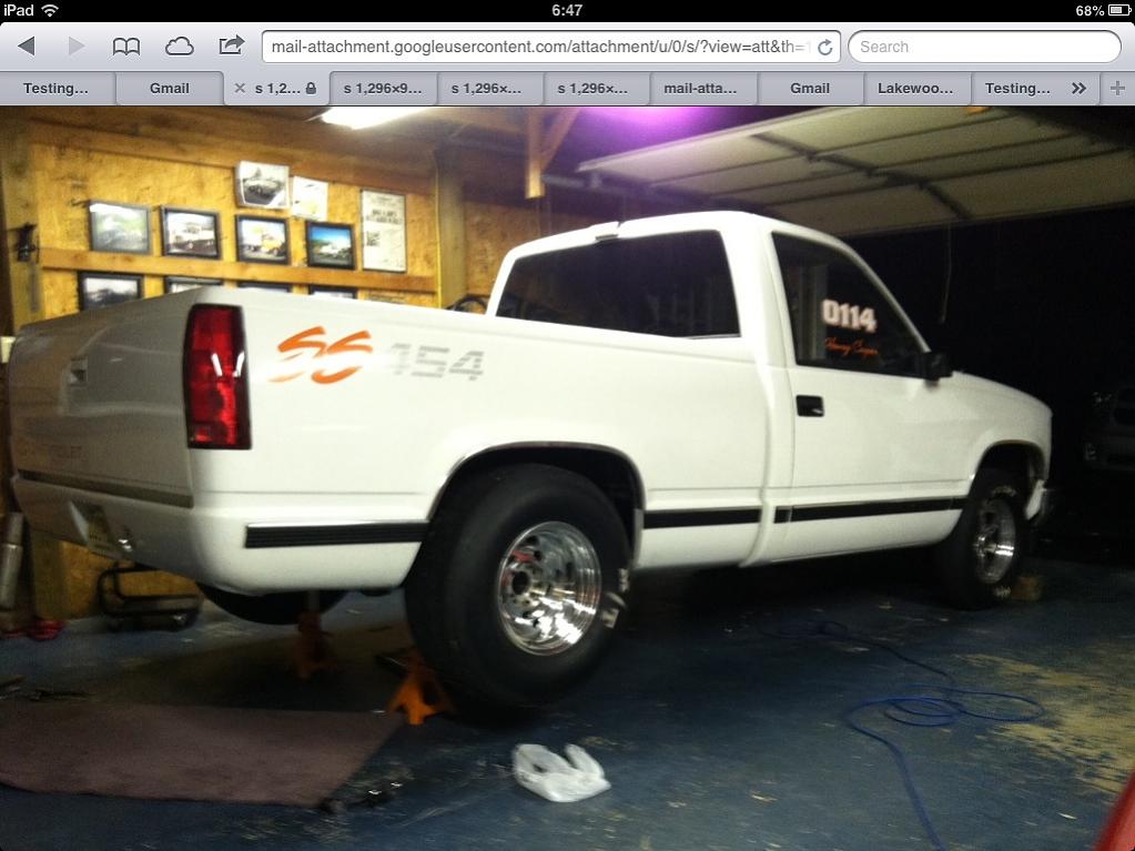

More from the garage

My old shaft was 3" this new shaft is 4" and just fits inside the new driveshaft loop with approx. 1/4" of clearence on each side of the shaft,I hope thats enough.The new 4" shaft with hardend yoke and 1350 pinion flange and upgraded universals 59" long was $580,ouch when is it going to stop bleeding $$$$$ lol
