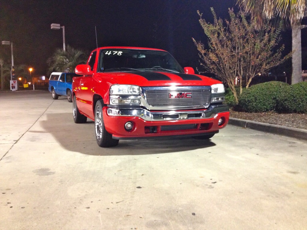

First I want to say thanks to those who got the truck this far, these guys hands down make good parts that work.
God@ Heaven for keeping me safe
Chris@ Circle D
Jake@ JakesPeformance
Kyle@ KBracing
Lebbet@ Boostlab

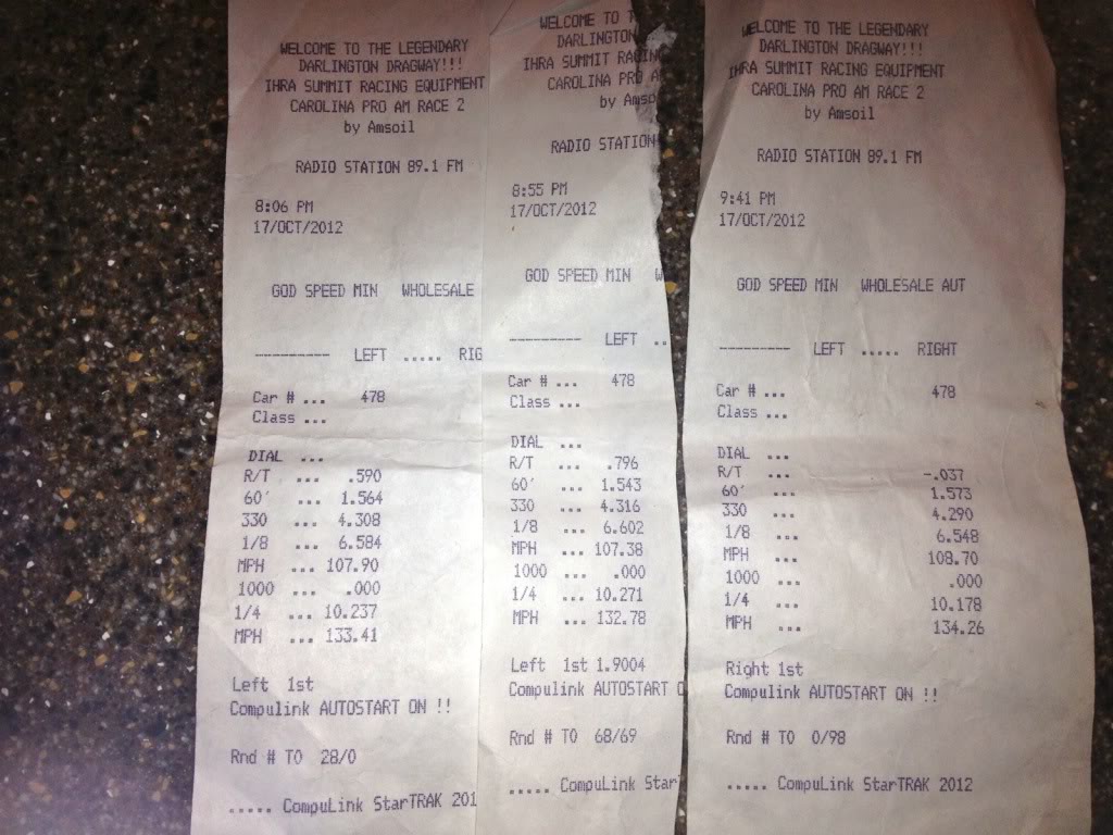

On to tonight, first time out with new BW unit by Boost lab. I left it at 15psi as that maxes out my 102lb injectors and it held a 11.6-11.9 air/fuels.
Full weight, minus passenger seat and track tires, comes in at 4580. First pass left at 3300 2step / 5psi. Second and third pass at 3400, truck dead hooks but lacked some kick to power those deeper 60s. Nitrous was on 2200-3000 to get it on the 2step faster, but off during the pass.
Also shifted the second pass at 6500, mph went down, so I shifted at 7000 like I did on first pass, seems this cam/turbo work very well together up there.
Excited and ready to go for it with 35 set to come on at 4200 to 6900, two wrecks happened back to back and closed the track for the night. Wasn't meant to be for 9s! I need to try 3500 to get it 60 better or let the little 35 wet shot 60 foot it or eat the whole way.... Maybe next time, this turbo is extremely strong at 15psi and the rest of the truck is working awesome.
