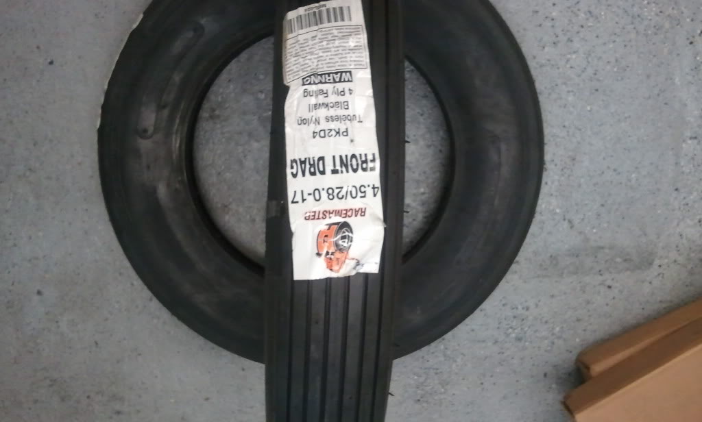

I showed the 325s for the rear for my wifes tbss last week here are her new front tires. She bought herself the trueforged 17x5/10 combo for valentines day

i see they say 4ply, do they make an 8ply or did you talk to them about the weight limit (if any) on these? streetable at all?
just curious..

they are made for the weight of our trucks no problem
and how did you come to this conclusion?
looks like a 2wd tbss weighs around 4600 correct?

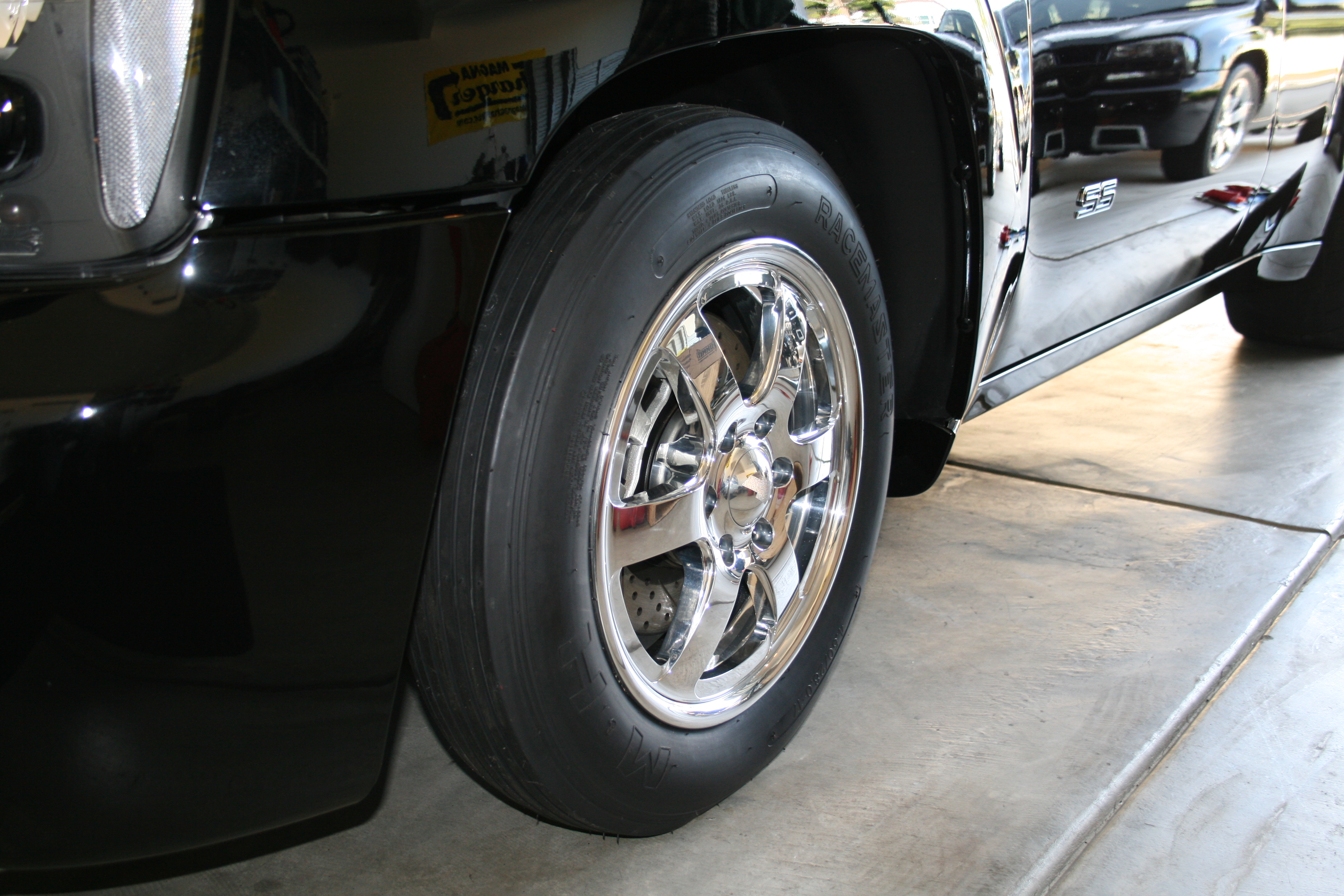

front tires are rated at 1500 pounds each. front of tbss doesn't weigh 3000 pounds

holy mother of giant pictures, size that thing down. looks great from what i can get in my monitor at one time..
she gonna drive on the street on those at all, or just strictly track shoes?

Think they are marginally OK.
Seems like I talked to John at M&H sometime back about front runners.
and it was a maybe on a track only deal, but my front weight is a little over 3000 lbs.
I can see where cornering could easily exceed rated lbs.
anyway I guess the point of the pic is they are rated at what 1886 lbs each at max pressure.

Most passenger car tires are 4 ply. 8 ply would be a load rating of at least E 1 ton truck etc and would be extremely heavy
