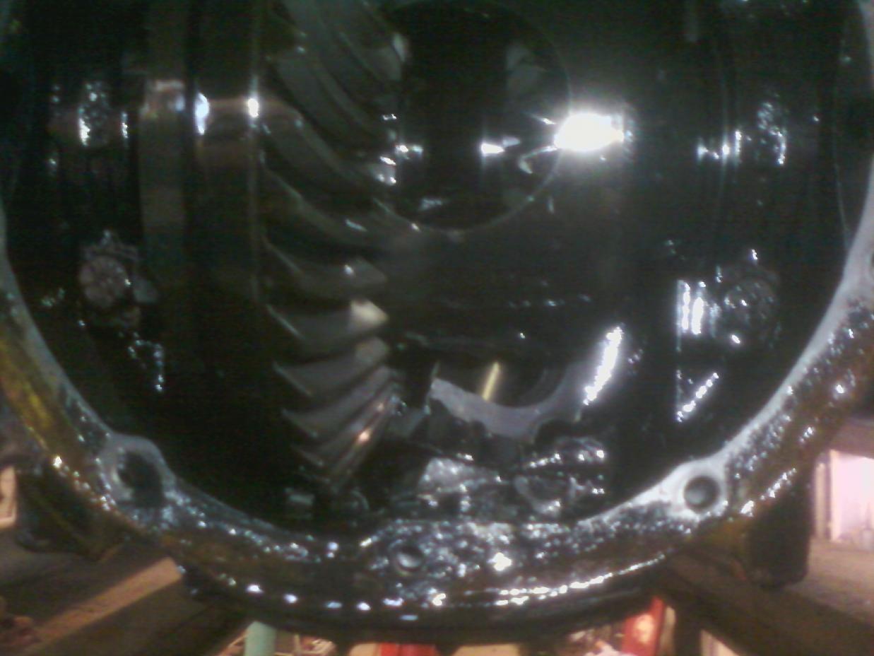

Old Oct 1, 2012 | 09:45 PM
Johnmaster's Avatar
MASS seller approved
Joined: Apr 2011
Posts: 324
From: Mukwonago, Wi
I guess I wont need to worry about my technique anymore...

Old Oct 1, 2012 | 09:51 PM
cammed00's Avatar
Joined: Feb 2012
Posts: 1,157
From: Ft.Worth
Sweet carnage!! Mine was kinda like that when I upgraded to 4.10's.
