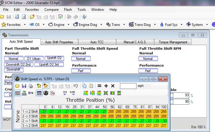

Is your D1 Urban table maxed out for all TPS positions to prevent a forced upshift? Is logged TPS holding steady at 100% when this occurs?
My tuner was talking about the D1 Urban table. Where is it in HPT ?
It will show up under auto shift speed if HPT has made it available for your OS.

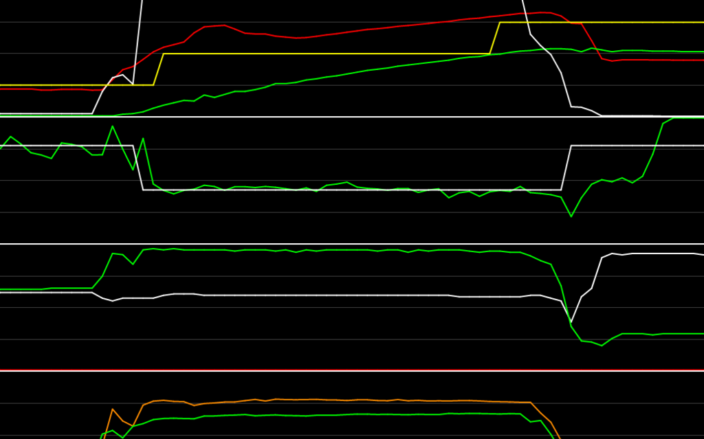

Looking at the log pic, it seems it is taking a while to actually shift after the command is given. I don't think the problems are in the tuning. Do you have a snap shot of the log where it short shifted to second? Since it was after you were in line for a while, what was the trans temp when it malfunctioned?
Temp was 199 and IAT was 127..fricken hot.
The shift to 2nd commanded at 9mph

Not that 200 degrees should be putting the tune into trans overtemp but it is worth looking into the 'hot' trans settings.
