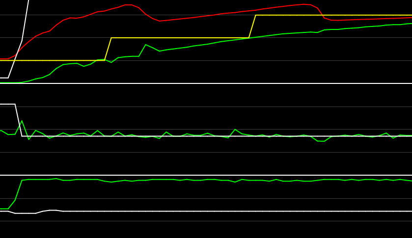

First run it actually shifted. I commanded 6100 and she ran good. Tons of wheel spin. Ran 7.3 @ 92 still not in racing trim.
Motor ran good, timing 27.5, AFR was all over 12.5, no knock, and rpm drop at shift was only 6200 to 4980, 6200 and 5050.
Got back in line and watching my current gear, it was going back and forth between 1 and 2 while in first manually. I launched and it went right to second gear about 22 mph................... POS
