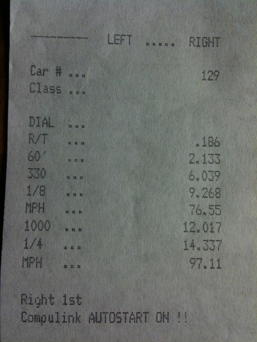

brought her to the track today with about 800 miles on the clock to get a baseline before mods...

2.133 60'
14.337 @ 97.11 mph
