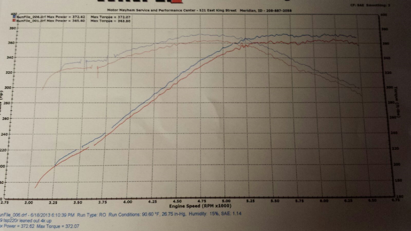

Do you have any pictures of your dyno chart? I'd really like to see it.

Yea I mean i have no doubt that your stock injectors arent keeping up. hell I ran out of my stock injector with bolt on mods only with my LQ9. You are also giving up a little on the top end, but probably not as much as you think. I could see maybe 10 HP around 6k, but honestly I wouldnt expect that cam to carry all the way to 6500 anyway. Spinning it that high you will definitely see some gains from the 87mm intake
Do you have any pics of your Exhaust? im looking to do a 3.5" side exit myself... is yours before the rear tire also?
Side note, you shouldnt be hitting 3rd gear until almost 90MPH depending on your shift point... is that the case? And yes, its such a long gear with 3.73's that I'm sure it doesn't feel all that strong.

Ya it was around 2500-2700ft when I ran that day. Im shifting at 6300 and just ran it up that day for the dyno. My buddy has my exact same setup and his made 384whp with 36lb injectors. His hits peak at around 5700 and only falls off a touch to 6400. when I say it falls flat in 3rd I mean it falls WAYYYY flat. Definitely goin lean and pullin timing. I think the injectors will help a lot. My 3.5 inch is just before rear tire. Short 3.5 pipe to muffler and then it 45s shortly after muffler and keeps that angle to the back tire. Didn't wanna put a 90degree turn in it. This truck gained almost 10whp goin from 3in to 3.5in piping. These motors like flow.

The thing to remember is when you shift into 3rd you're now at 4000 RPM maybe... there is no fuel starvation going on at that RPM.
