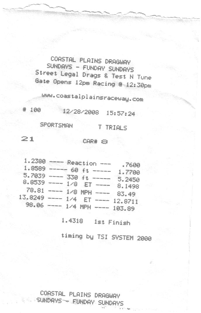

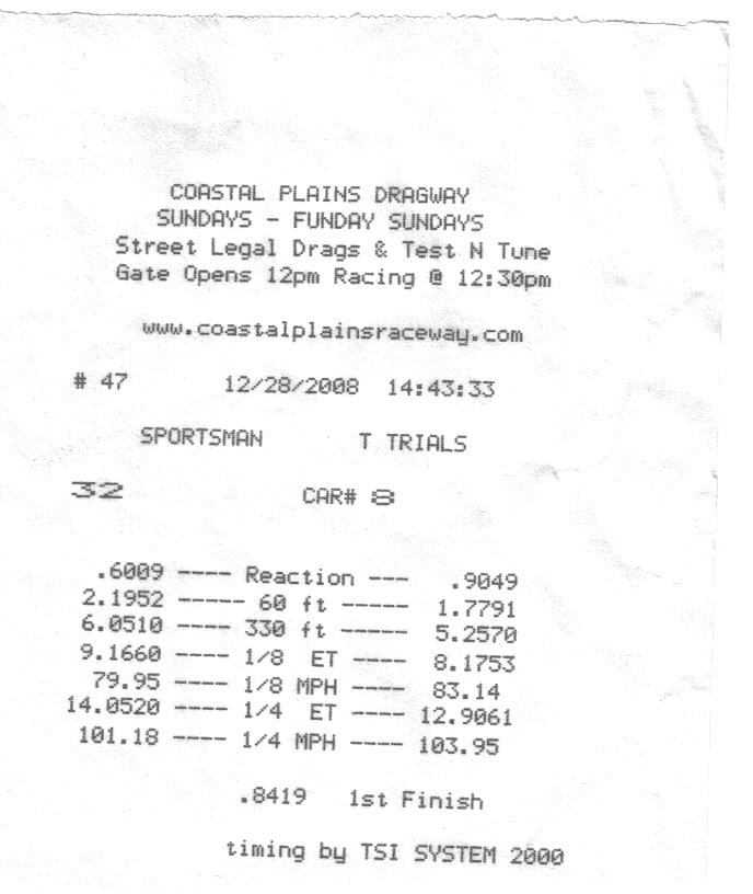

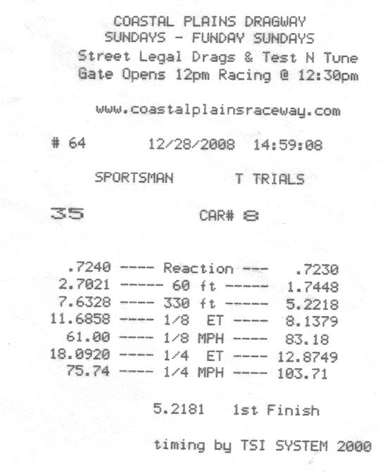

Still alot left on the table but for a first track visit, I think it went well.
For those of you who don't know, I took out #3 piston for the 2nd time in June of this past year and decided to go the stroker route. 392 stroker with CP pistons, Eagle rods and Compstar crank. Cam is 221/225 on a 113 with 6-7* advance sprocket. I still have the plastic truck intake and the same CAI from 4 years ago. The truck is 4wd with 3.55's..(I know, I know). Hemifever tunes it via SCT and was with me at the track first time out. Best of 12.87 at 103.89, worst of 12.94. Made 6 passes at Coastal Plains dragway in NC, DA was +1200ft.

awesome job buddy. you,inertia and hemifever fing rock

Sweet. Congrats on the new times for ya. Thats moving for a truck, even if it is a dodge

also remeber his truck wieghs like 5k lbs and only has 3.55s in the rear

I saw your passes in person, i was in the black slomaro ss! I figured that there was a power adder on that, jeez that thing runs out very well i got into the 12s that day also!!! Congrats
