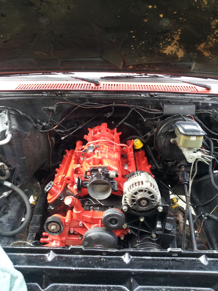

I will most certainly be getting a 4l80e when the time comes. Trans and engine mated up perfectly, and the only issue was drilling the 6.0 flexplate for the TH350 converter. The part that made it hard was doing it all by myself, just one buddy would have made a huge difference in getting it in there.

Looks great sitting in there! What did you figure out was causing the tranny from bolting up? Did you have to shift it forward at all?

What was stopping it from bolting up was me, and having to run back and forth between the front of the truck an sliding under it. Word for the wise, get a bud to give you a hand.

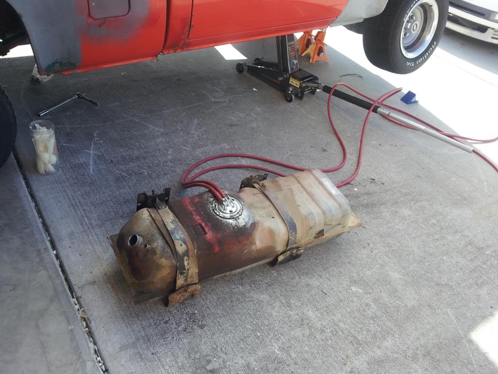

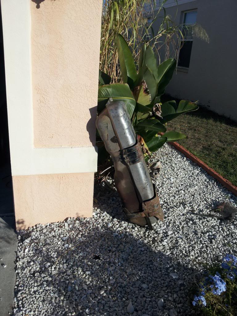

Got the tank out, modded one tube and made it my return line and the other shall be the feed. Once the tank is empty I find that you really don't need a jack for the tank. Slid under the truck, moved the tank from my stomach to my knees, raised it up, put in all 8 bolts and that was that.

Got all the lines ran and even wired up the Walboro 255 pump. Will install my fans tomorrow as well as the starter. Had to retap the oil pan for the turbo drain...not pretty but we shall see what happens.

Nice build looking good. Are you using stock tank and sending unit with external walbro 255 or is it internal pump??
