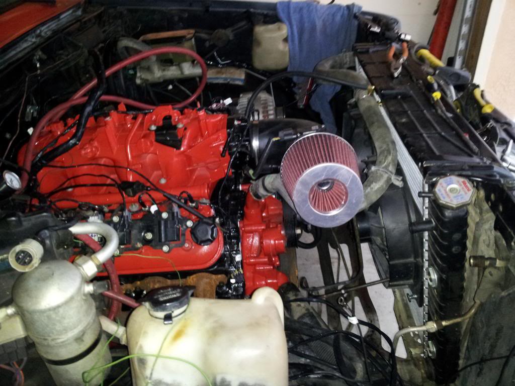

Went to LKQ and got all my needed hoses, ie, upper, lower and brake booster hose as well a belt, all of a '99 1500; for a whopping $8.

Finally got the beast started over the weekend. Once I figure out how to edit my video, i'll post it. Still have more to do, but that was exhilarating.

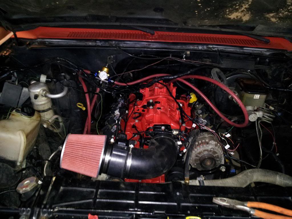

'84 C10 Stock lines right into the ls pump friend. They are hacked up 98-02 f-body fans that a bud had on his S10/ls swap. For $40 it could not be beat.

Got her started and took her for a spin. Still needs work but boy did it feel good.
