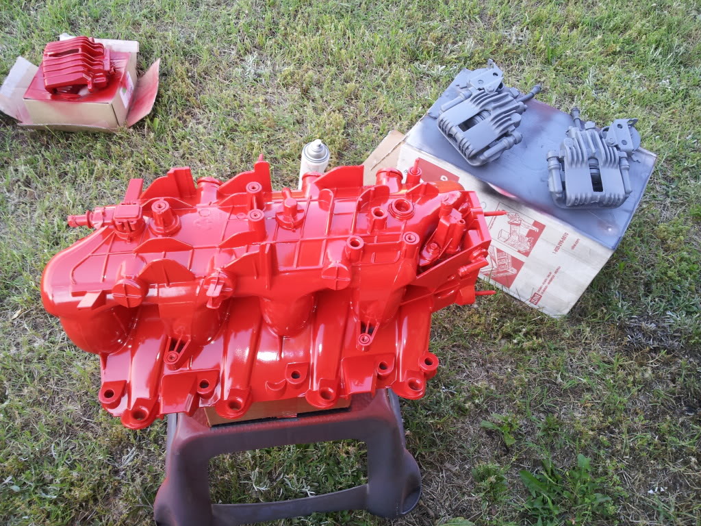

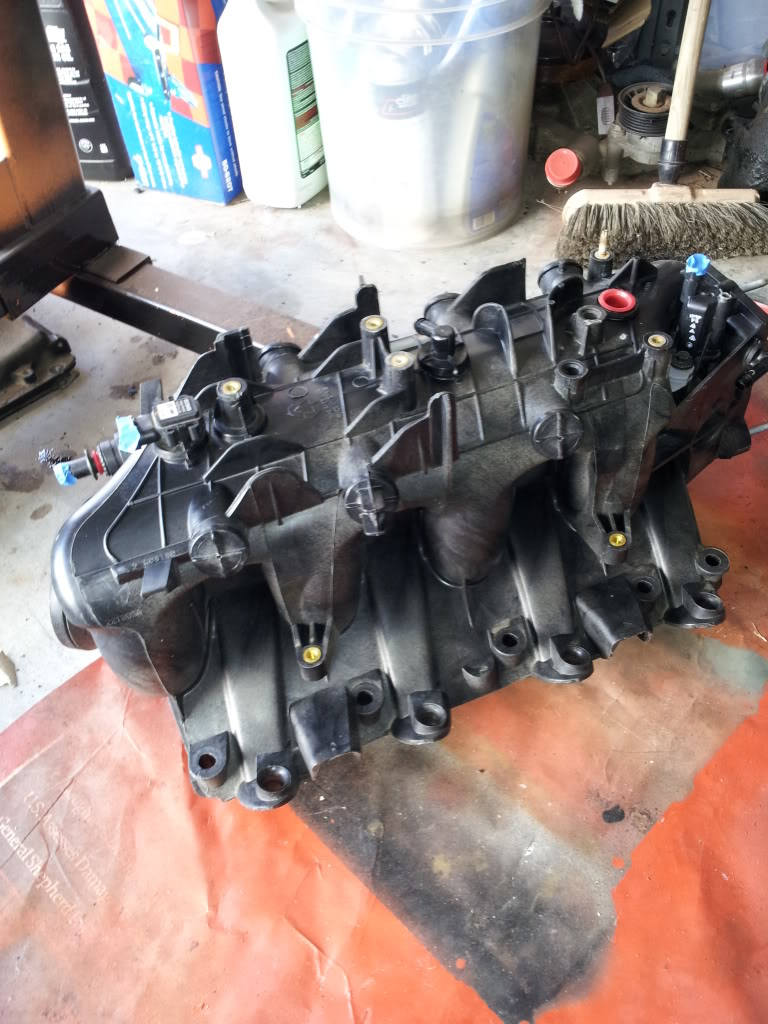

Getting the TBSS intake ready to bolt up next week. Painted it red even though it will be covered by the SS cover.

The paint looks really nice. Too bad those Darth Vader things are so ugly.
